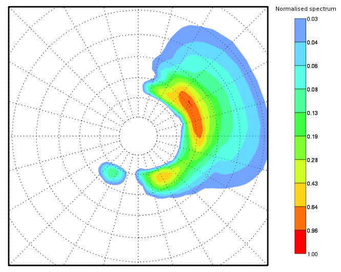

How can you make a 3d polar surface graph (angle, radius, value) ?

There are the Polar series and the Surface series. I'm not sure to understand what exactly is a 3D Polar Surface. Could you please show us a picture of it?

I've received your picture showing how the polar surface looks like. Thank you.
I post it here for other customers benefit (if you want me to remove it, don't doubt to ask for it)
There isn't a series specially thought to do something like that. However it can be done with a TPolarSeries and some customization:

With it, you "only" need to know the Angles and Values for all the points to draw each surface. Of course, each different surface has to be a different TPolarSeries, even if they represent the same "surface" level.
