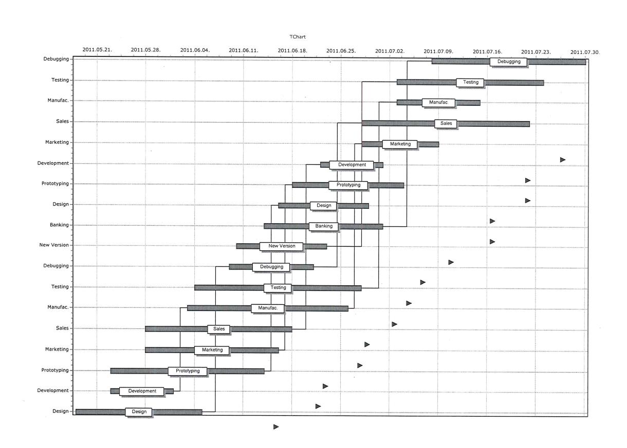

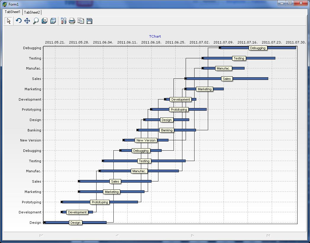

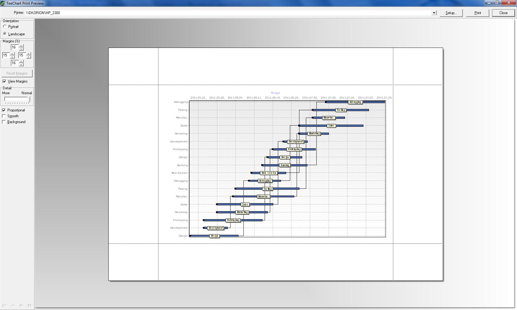

There is an anomaly when printing Gantt series charts.
I have created an empty project with just one Chart, and added random data during runtime. The chart and the print preview are perfect, however printing the chart prints the pointer arrows to the wrong places. See the attached images, first is about the program, second is the print preview, third is scanned back from the printed paper.
Arrows are "created" with Marks visible, Pointers visible, and Pointer Style is right triangle.
Can anyone help me, how to print the pointers right, or is this a bug in the chart?

Hello Peter,
You are right. I've reproduced it with the code below, printing the chart through the "print" button in the commander and printing the chart with a pdf virtual printer (CutePDF writer). So I've added it to the defect list to be revised for future versions (TV52015575).
uses GanttCh;
  Chart1.Legend.Visible:=false;
  Chart1.View3D:=false;
  with Chart1.AddSeries(TGanttSeries) do
    FillSampleValues(7);
    ColorEachPoint:=false;
    Marks.Visible:=true;
    Marks.Callout.Visible:=true;
    Marks.Callout.Style:=psRightTriangle;
However, I've also seen that using the StretchDraw method here, it's printed correctly.
