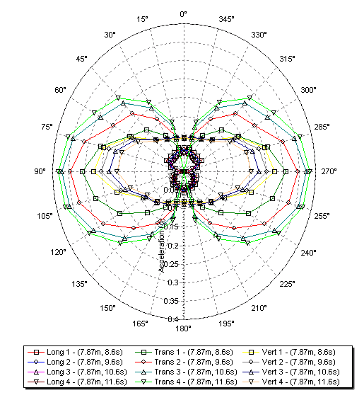

I have a migration issue which I hope you can help with. We have a legacy BDS 2006 C++ builder project which also used TeeChart 7.08 components to create a polar plot graph. We have migrated the project to RAD Studio 2010 and TeeChart v2010 VCL.

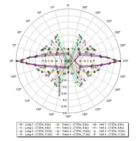

Below is the good polar plot from BDS 2006/TeeChart 7.08 (ignore the squashed effect, this is due to a remote connection)
good - bds2006-teechart708.png (21.69 KiB) Viewed 12999 times

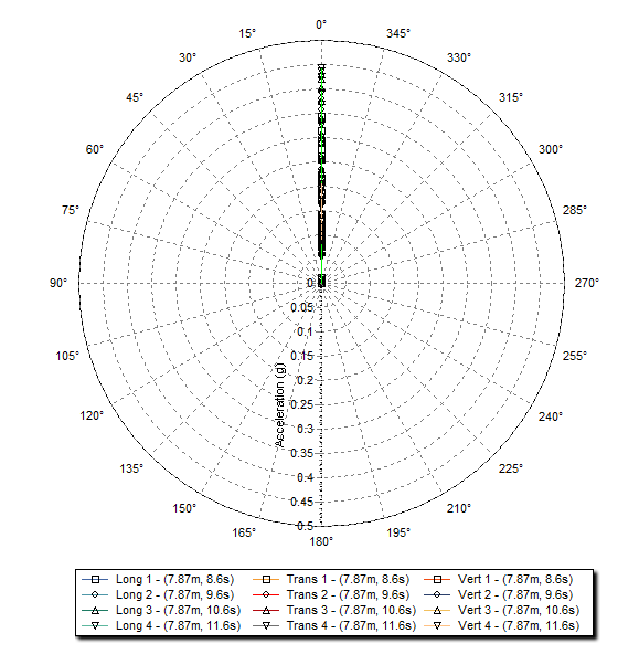

The problem I now have is that all points on our polar plot now appear on the zero degree line, that is they are scattered between the origin and the top of the polar plot. Are there any changes to the components in the intervening versions that could account for this behaviour, or is there something I could check for in our code that may be causing this effect?
Below is the incorrect result in RAD Studio 2010/TeeChart v2010 VCL

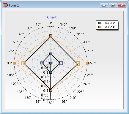

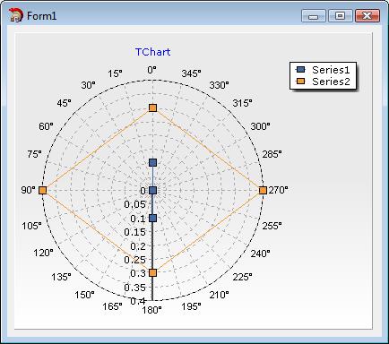

I am still having trouble with this. I have created a small project to demonstrate the issue.
In the code, I add some values to two series:
Series1->AddPolar(0, 0.1);
Series1->AddPolar(90, 0.1);
Series1->AddPolar(180, 0.1);
Series1->AddPolar(270, 0.1);
Series2->AddPolar(0, 0.3);
Series2->AddPolar(90, 0.3);
Series2->AddPolar(180, 0.3);
Series2->AddPolar(270, 0.3);
Neither of the resulting series give me what I expect:
polar series.jpg (31.37 KiB) Viewed 12986 times
I have (admittedly crudely) photoshopped my expected result over this screenshot (I just used black lines for illustration, they should be in the same colour as the series of course):
polar series - expected.jpg (97.53 KiB) Viewed 12985 times
I hope this helps, I really need to solve this soon.
Steve.

It only seems to me a question of axis setup. If I add the following to your code I think it looks as you want:
	Chart1->Axes->Bottom->SetMinMax(0, 0.4);
Note that at design time you've forced Left axis (vertical axis in TPolarSeries) to automatic=false, minimum=0 and maximum=0.4. With the code above I force the same for the Bottom axis (horizontal axis in TPolarSeries).

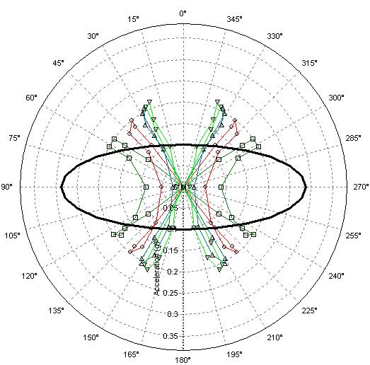

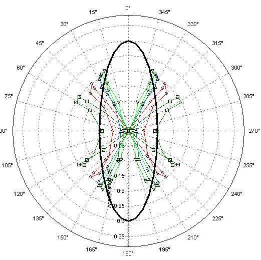

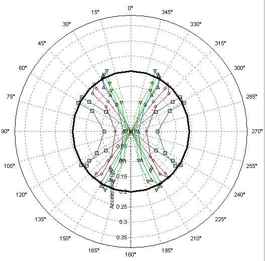

I added a simple black ring to the graph using another polar series. The radius value can be changed dynamically in the application.
When this ring is drawn, the point coordinates seem to be adjusted proportionally somehow. The series is set to circled and each point is added at the same radius value, so I expect to see circles, instead I see ovals when the radius value is 0.1 or 0.3 and an approximate circle at radius 0.2:

Is there some way to disable this proportional effect and just draw the points exactly as I specify them?
