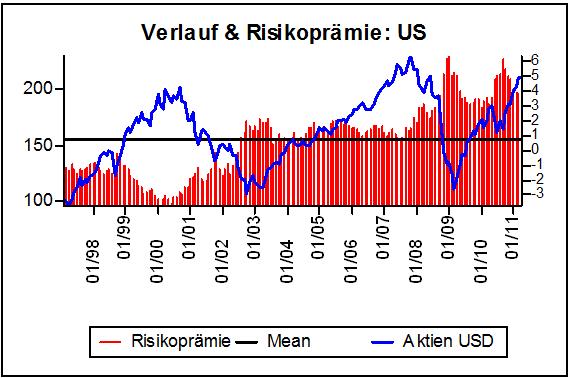

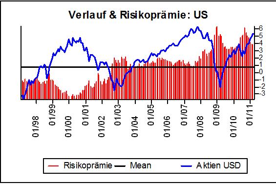

When I select Logarithmic in the editor for the left axis then the labels don't appear (on left axis), please refer to attached pictures of the same chart. The increment is 20 and except for Logarithmic all other options are the same (between the two pictures of the graph). How do I get the labels to appear without using draw all labels (as this would show too many labels).

- Logarithmic not selected for left axis.
- log_not_selected.jpg (45.11 KiB) Viewed 5063 times
- Logarithmic left axis selected
- Log_Selected.jpg (44.6 KiB) Viewed 5050 times

Hello Vincenzo,
I see in your left axis that the values in your series are from about 100 to about 250. In a base 10 logarithmic scale, the values are ..., 0.01, 0.1, 1, 10, 100,... So with your values, only the 100 label should be drawn in that scale.
