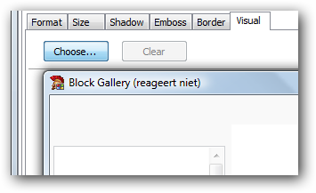

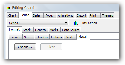

Here another problem with TeeChart:
Delphi 2007 Professional, december 2007 update
TeeChart Pro 2011.03.30407
Windows Vista Business SP2
Create a new VCL forms application.
Drop a TChart component on the form.
Add aTBarSeries.
Edit the Series as shown in the screenshot.
Delphi hangs when you press the button 'Choose ...'.
There is no other option than killing Delphi.
Bert
