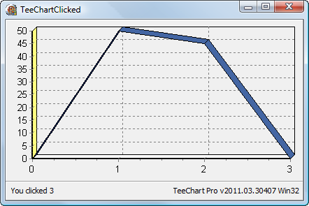

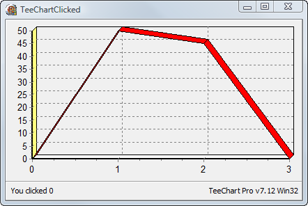

I discovered 2 bugs (going from version 7.12 to 2011.03.30407) that are demonstrated in the attachment:
1) Click a line and see what .Clicked() returns. Version 7.12 counts from 0 and version 2011 counts from 1.
2) In version 7.12 the fonts are rendered with ClearType, in version 2011 they are not.
Bert
TeeChartClicked.rar
(1.24 KiB) Downloaded 802 times

Bert B. wrote:1) Click a line and see what .Clicked() returns. Version 7.12 counts from 0 and version 2011 counts from 1.
Yes, I see in v2010.01 it still worked as you want, taking the index of the left point. And I see from v2010.02 it takes the index of the right point.
I've added it to the wish list to be investigated for future releases (TV52015540).
Bert B. wrote:2) In version 7.12 the fonts are rendered with ClearType, in version 2011 they are not.
I think this is relative to an existing item in the wish list (TV52015253).
In the meanwhile you can workaround this adding the TeCanvas unit t the uses clause and setting the TeeFontAntiAlias as follows:
TeeFontAntiAlias:=DEFAULT_QUALITY;
