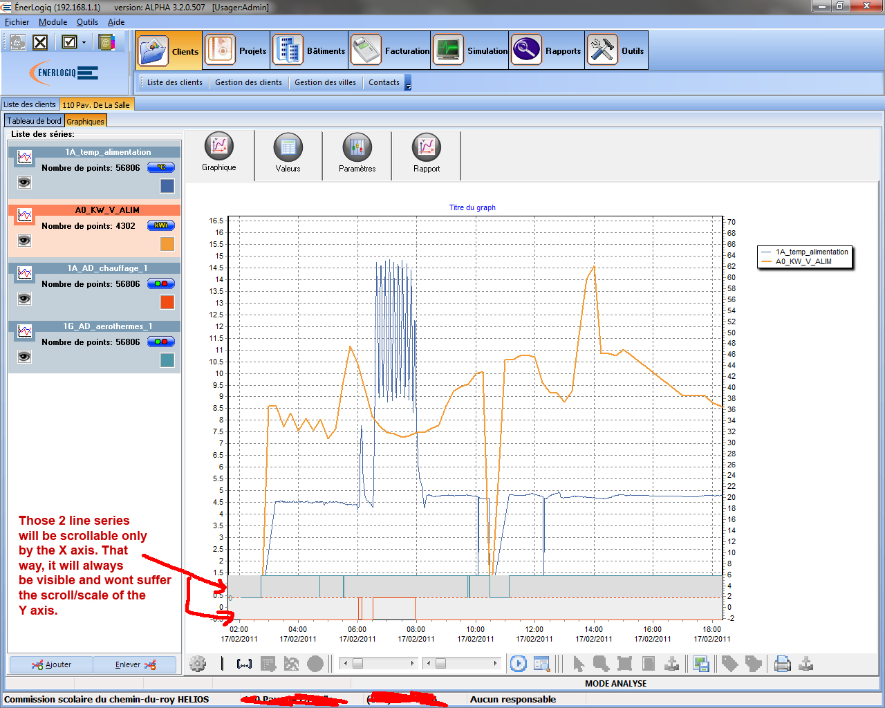

Hi again
I though you may need more information. So there is a screeny of what i have done so far.
ScreenShot about the line series without Y axis
I did paint the background to be easier to see the 2 lineSeries.
As i told you before, im using the TChart.Series for a lots of stuff (Live Reports, Saving the graphics into my DB, showing a table of values, etc..)
GoToXY
Posts: 81
Joined: Thu Apr 03, 2008 12:00 am
Re: Drawing series without Y axis
Post by GoToXY » Sat Mar 26, 2011 1:39 am
Oh well, im sorry to have bother you again. Sometimes, my brain just want to remake the world in its own way! :? Anyway, i just figure out that the only thing i had to do is to create a new kind of series from TSeriesLine and override the DrawValue fonction and then, add my code in it. So simple. I must need vacation lol.
Thanks to you to have make it simple as that to make custom series ect... I just finished it and it works like a charm!

I need the scrolling option for the other series. Only the On/Off series must be unable to be scrolled by the Y axis. But thanks anyway for the idea.
Post by Narcís » Fri Apr 01, 2011 10:17 am
Hi GoToXY,
In that case 2 charts or a subchart tool would be the way to go, as Yeray suggested. You could then restrict scrolling to horizontal for the chart you need.
