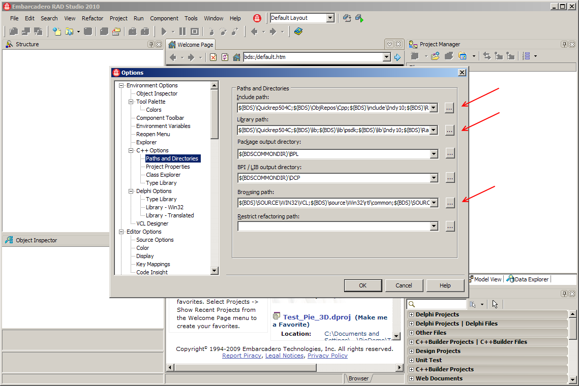

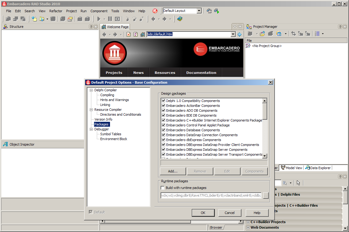

When I talk about the package list, in RAD Studio 2010 (with no project opened) it is at "Project/Default Options/Delphi" or "Project/Default Options/C++Builder":

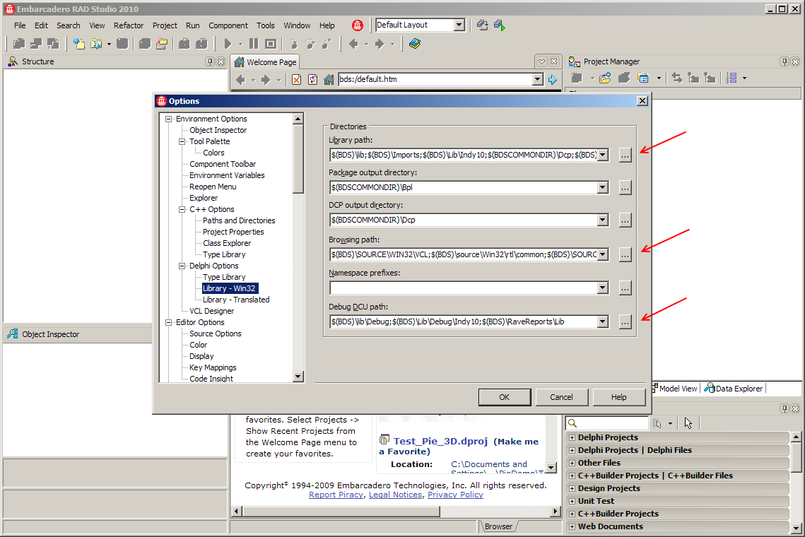

When I talk about library path, search path, include path... I meant the lists in "Tools/Options...":
If the problem remains or you find any error you can't solve at any step, please don't hesitate to let us know.
