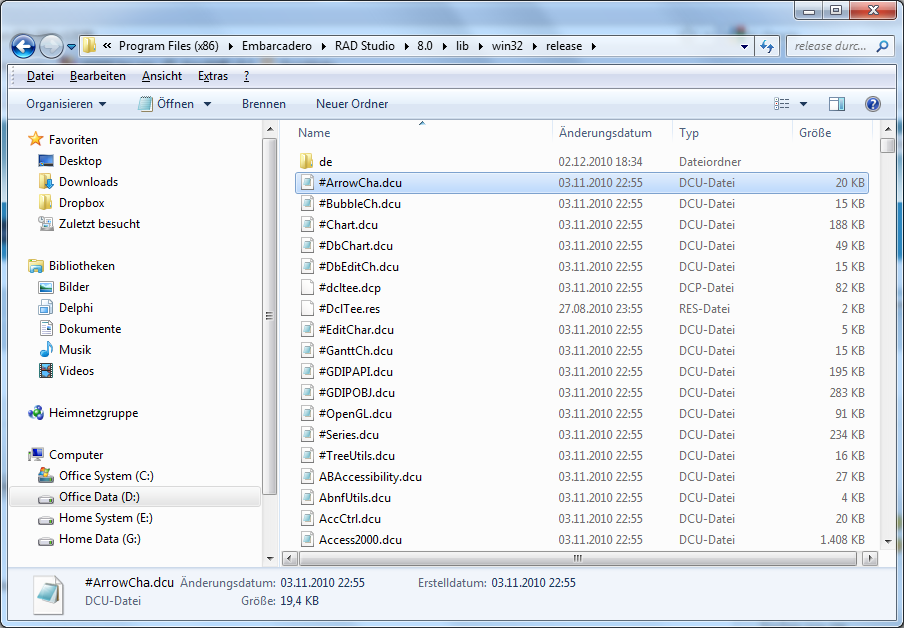

The main reason for the trouble was that the "$(BDSLIB)\$(Platform)\release" directory contains old teechart units from original Delphi XE installation. Since I new that before installing the 2010 version I tried to uninstall the old version of teeChart. But I was not able to. To Steema: Is there any possibility to remove the original version of teechart that comes with XE first?
I have attached a screenshot where I renamed the old tee files (with a leading #). I am not sure if I found all or if I renamed too many (anybody has a list?)
But after this everything worked fine (with one exception I posted 10 minutes ago: gradient problem).
Now you can move your teechart lib and bin folders in the library declarations of IDE where you want.

I had the same problems using Delphi XE and TeeChart2010 on Win7 X64.
