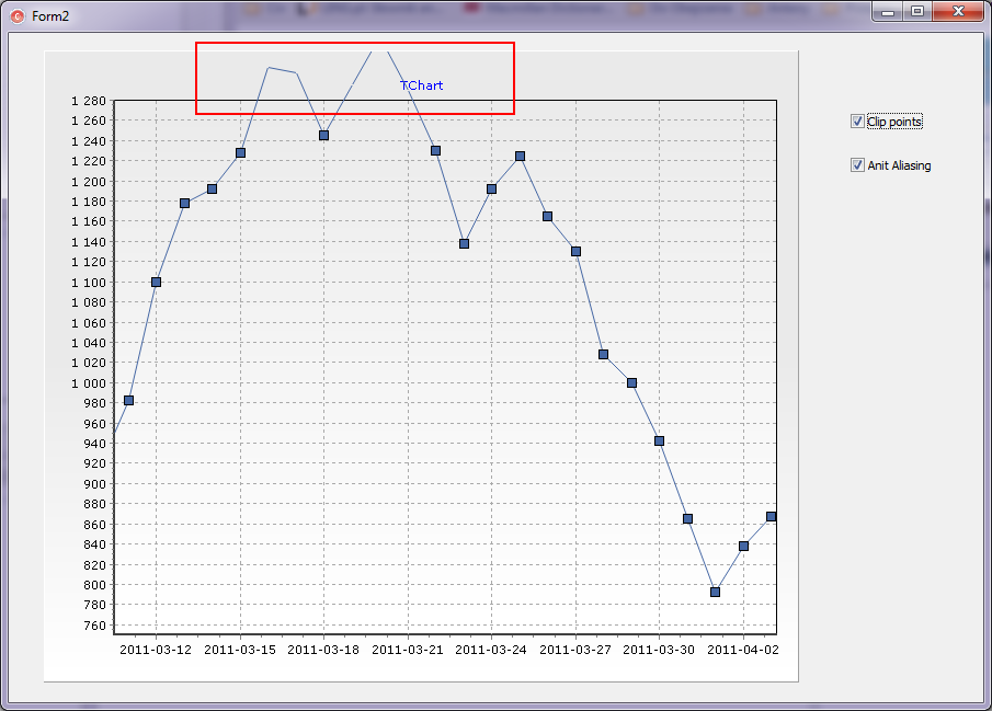

After upgrading from TeeChart 7 to TeeChart 2010 I tried to use tool TAntiAliasTool. Unfortunately TChart doesn't clip line series if TAntiAliasTool is active. Is it a bug or some TChart properties should be set to enable clipping?

Screenshot

Post by Yeray » Thu Mar 10, 2011 2:54 pm
Hi Jarek,
This is a known problem already in the defect list to be fixed in future releases (TV52015427).
However, with GDI+ clips the points correctly in the chart rect.
uses Series, TeeAntiAlias, TeeGDIPlus;
  Chart1.View3D:=false;
  Chart1.Legend.Visible:=false;
  //Chart1.Tools.Add(TAntiAliasTool);
  Chart1.Canvas:=TGDIPlusCanvas.Create;
  Chart1.AddSeries(TFastLineSeries).FillSampleValues;
  Chart1.ClipPoints:=true;

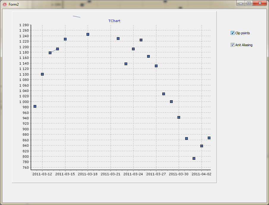

I've installed TeeChart 2011.03 and tested bugfix:
16) [TV52015427]
TAntiAliasTool not clipping series points correclty. Fixed.
As you can see in an attached screenshot, almost all lines connecting points aren't drawn at all. Line connecting two clipped points is not clipped.

Post by MagFly » Tue Apr 19, 2011 8:06 am
With the latest release, TeeChart v2011.03.30407, I also get this error on line series when the pen width is 2 pixels.
If I change to 1 or 3 pixels for the lines pen, it renders ok.
It worked in the release 2010.02.20202.

Post by Sandra » Tue Apr 19, 2011 8:12 am
Hello Jarek,
You are right. I inform you we are working with this bug to fix the problem as soon as possible.
