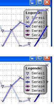

As I'm showing the legend of my chart only on demand (click) i would like to have it drawn on top of the grid and all series (lower image) but it seems always to be shown below (lower image).
Is there a way to accomplish this?

I've attached a simple form (no code). When I open the form the legend is drawn behind everything (actually showing the back wall completly hides the legend). This is the form, where yesterdays screenshot origins from.
I've had that with the older version of tchart as well as with the current (2010.02.20202).

The problem was ResizeChart property set to false. To achieve what you request you should set legend to a custom position as in the code snippet below.
  Chart.Legend.ResizeChart:=True;
  Chart.Legend.CustomPosition:=True;
  Chart.Draw;
procedure TForm1.ChartAfterDraw(Sender: TObject);
  Chart.Legend.Left:=Chart.ChartRect.Right - Chart.Legend.Width - 10;
  Chart.Legend.Top:=10;
