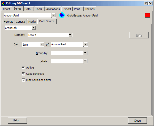

If I add a Chart with aTKnobGauge series on a form and want to use a TDBCrossTabDataSource then I get an accese violation. It seems it's not possible to use TDBCrossTabDataSource on gauges. But what kind of datasources are supported then? I can't anything of it in the helpfile neither on the forum.
And how else to add data to a gauge series?
Eric
Re: TKnobGauge and other Gauges
Post by Yeray » Wed Feb 23, 2011 11:21 am
Hi Eric,

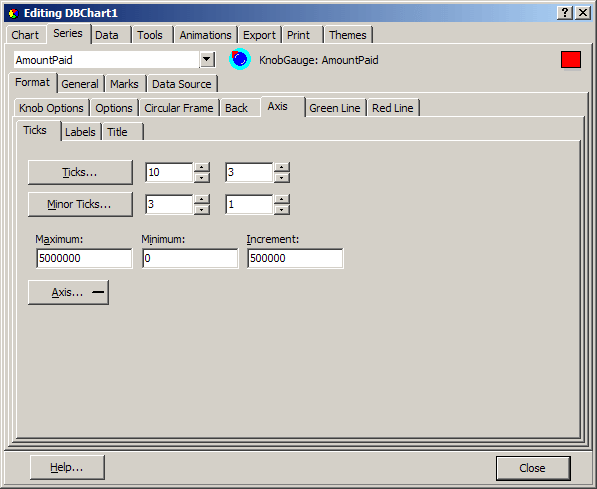

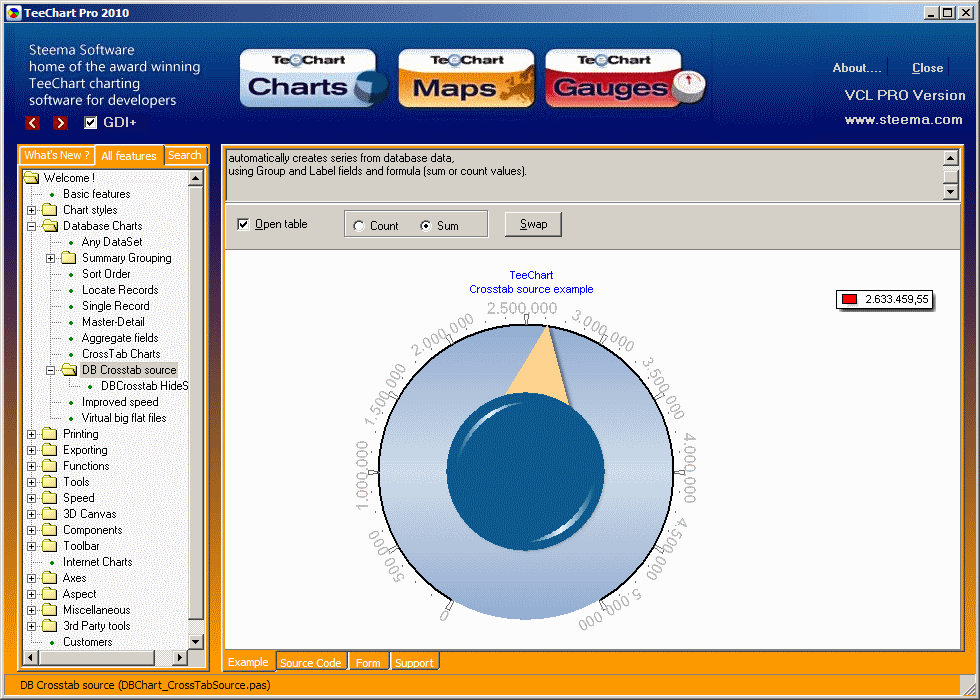

I've tried it in the feature demo "All features\Welcome !\Database Charts\DB Crosstab source", changing the Bar series to a Knob series and it seems to work fine.
Here are the captions:
