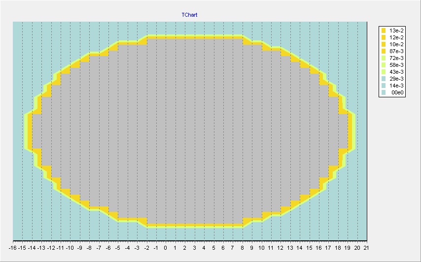

There was a mistake on the screenshot from your previuos post: the central area of figure must not be grey colored. Maybe it is a bug with a Palette using. I found what the subfunction CalcFirstLevel of method TIsoSurfaceSeries.DrawCell(x, z: Integer) returns the wrong result - second level in palette. I changed the CalcFistLevel how it looks below. You can see the result on screenshot. It seems that the Controurseries and IsoSurfaceSeries fill correctly.

Filled ContourSeries

I've added your suggestion to the wish list to be studied for future releases (TV52015423).
Anyways, I'm glad to see you've found a way to draw it as you want.
