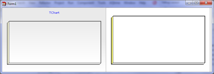

I have exactly the same issue.
I recently upgraded to from C++ builder 2007 to XE, and upgraded to TChart2011.
As mentioned above, the tchart backgrounds in existing projects have turned to white, rather than their normal clBtnFace. The behaviour of what a chart defaults to is different compared to a chart made in design time vs a dynamically created chart.
Dynamically created chart:
Will have a tchart with a white background and a white back wall. The back wall transparent propert defaults to true. Changing it to false produces a dark grey back wall.
Design time created chart:
If I make a new TChart in design time, it now defaults to a gradient background.
The back wall transparent property defaults to false.
The back wall gradient defaults to true.
Turning Panel->Gradient->Visible = false, products a white background.
Setting the Panel color has no effect. As near as I can tell, keeping the gradient visible, and setting the start and end colors is now the way to set the background color. Attach is a screen capture of what charts default to at design time (left) and dynamically created at run time. To return my dynamically created charts to what they were before, I'm now adding the following code:

- Design vs Dynamic created charts
- TChartDesignVsDynamic.png (50.42 KiB) Viewed 23044 times

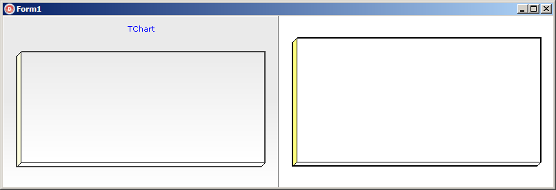

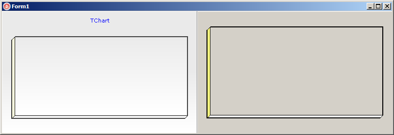

After investigating this we've concluded that it's not a bug.
In v2010 we wanted to give a better look to the new charts adding a gradient to the charts created at design time. However, we didn't want to change the aspect of the charts created at runtime to ensure backwards compatibility.
On the other hand in v2010.02 we found a related problem (TV52015430: "The back color (color of the panel) seems not to respond to the Chart.Color property"). This problem in v2010.02 has been recently solved
With v2010.02: With the TV52015430 fix: The fix will be available with the next maintenance release.
To create a "designtime looking" chart at runtime, you should set some properties manually:
