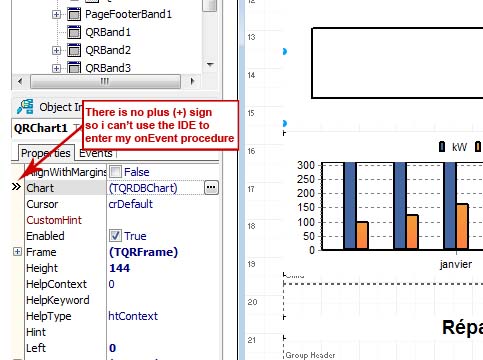

Is is possible to add the + before the chart in the TQRChart property to see and modify the properties and events of that one directyl from the IDE ?

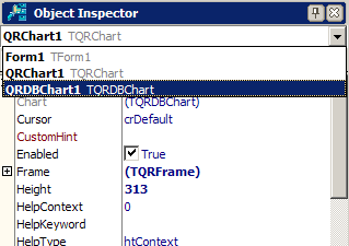

When you select the QRChart you have in the form at design time, the QRChart1 (TQRChart component) is selected in the Object Inspector.
However, you can use the dropdown list in the ObjectInspector to select QRDBChart1 (TQRDBChart component), like follows:

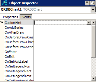

And there you can see the Chart events at design time:
