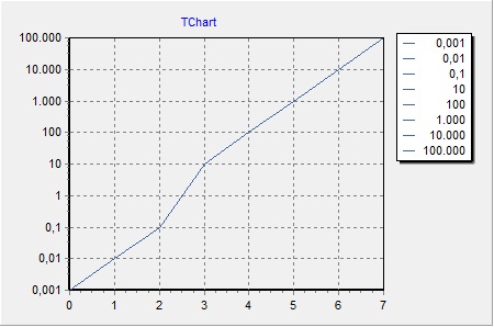

Sorry for the delay. I have made a new code using values from 0.01 to 1.0E+5:
And I have checked that in last version 8.07 it works fine as show in next image:
So, I recommend you download last version 8 of TeeChartVCL and check again if your problem persist.
I hope will help.

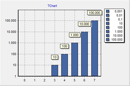

Re: 0.1 in logarithmic mode
Hello Nati,
I have done your suggestion and I have changed TLineSeries to TBarSeries:
And I get next result:
Could you confirm us, that your problem is the same of above image? If it isn't the same, please modify previous code, because we can reproduce it here.
