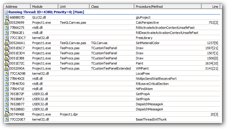

I compiled a sample application with one TChart3D component and activated EurekaLog. http://www.eurekalog.com/index_delphi.php
In EurekaLog I activated the Anti-Freeze Option.
When this option fires in EurekaLog, the following Call Stack is shown:
EurekaLog
C:\Windows\System32\glu32.dll
Date: 2-11-2006
Time: 11:46
Version: 6.0.6000.16386
Bert

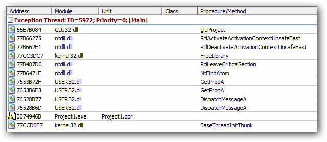

Post by Bert B. » Thu Apr 21, 2011 1:24 pm
After recompiling TeeChart with debug info:
Re: TChart3D causes crash of Delphi 2007

If I copy TeeGLCanvas.pas to my project and compile it with assertions, the following exception is raised:
'ActivateContext (C:\ ...\TeeGLCanvas.pas, line 1460)'.

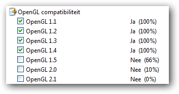

Everest (now Aida64) is a tool that shows a lot of information about the PC and the software. It says the following about OpenGL support in my PC.
My PC is a HP machine with Intel integrated graphics, so not state of the art.
I have ran the executable on 2 other PC's with old/integrated graphics and they have the same problem. On a newer machine with a recent Radeon card the application runs. This PC/graphics card has OpenGL 3.3 support.

I have checked a few PC's and a laptop with the test application.
Good:
RADEON 9250 - OpenGL 1.3 (XP)
RADEON X1650 - OpenGL 2.1 (XP)
RADEON HD 4770 - OpenGL 3.3 (7)
Bad:
Matrox G450 - OpenGL 1.1 (XP)
Intel 945G - OpenGL 1.4 (7)
Intel GMA 3100 - OpenGL 1.4 (Vista)
ATI Mobility RADEON 9700 - OpenGL 1.5 (XP)
Do you now the Delphi OpenGL Community? http://www.delphigl.com It seems they are very active with and knowledgeable about OpenGL. I downloaded one of the applications that is using their stuff and it runs fine on the laptop, where TeeChart isn't.
I tried to replace OpenGL2.pas with dglOpenGL.pas but couldn't get my application compiled. For someone with more knowledge it might be an easy change. It might be worth investigating.
