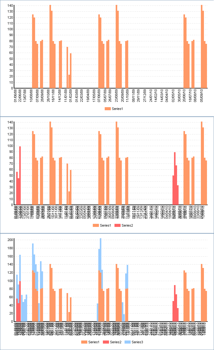

I'm having similar problems. The separation appears to be fine when there is one series on the chart, however when you add a second, third, fourth series and so on, the separation disappears as multiple labels are placed on the axis.
The labels for each series are absolutely identical and are weekly dates, but everytime you add another series the spacing gets worse and worse as it displays more labels. Take a look at the attached image file where you can see the axis labelling changing as each series is added.
I'm having exactly the same problem with every chart that includes multiple series. We have made no changes to our code which worked perfectly well in v8 and have just upgraded to v2010 as we're now using Delphi XE.
Any advice greatly welcome?
- Same chart with a series added each time. Look at the bottom axis labels.
- TChartAxisLabellingIssue.png (42.11 KiB) Viewed 18327 times

Thanks Narcis, I've uploaded the source for a simple app that adds a series of 300 random numbers each time you check one of the series in the list. You will notice that as you check each series on the bottom axis adds more and more date labels to the axis completely ignoring the min separation. This wasn't a problem with v8 and has only been introduced with v2010.

Thanks Narcis, I will keep track of the TV52015179 thread from here on. It does sound like the same issue so I will post any additional comments on that thread.

I just wanted to let you know that we have fixed TV52015179 for the next maintenance release.
