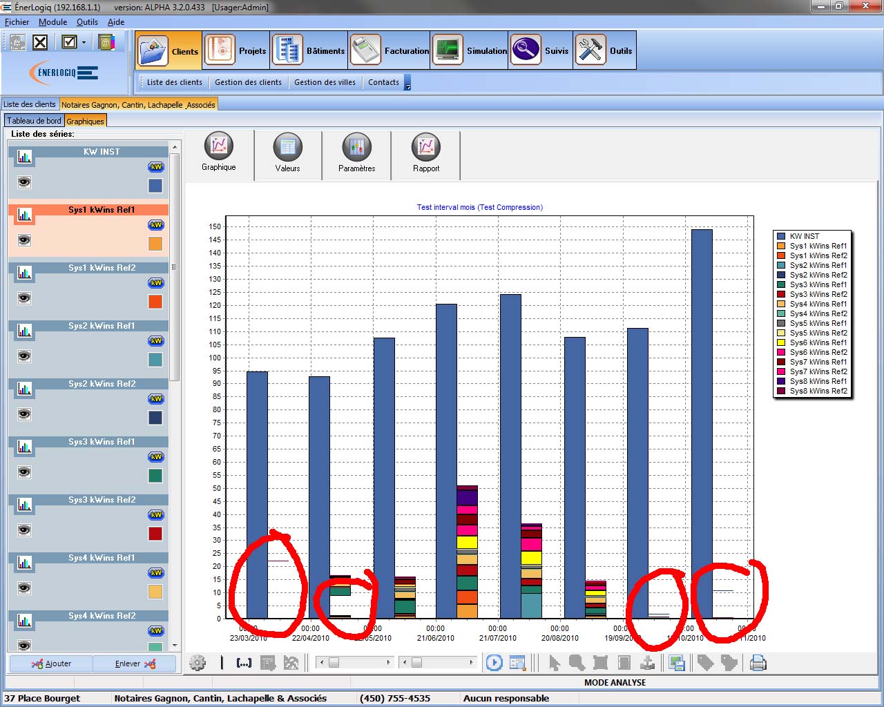

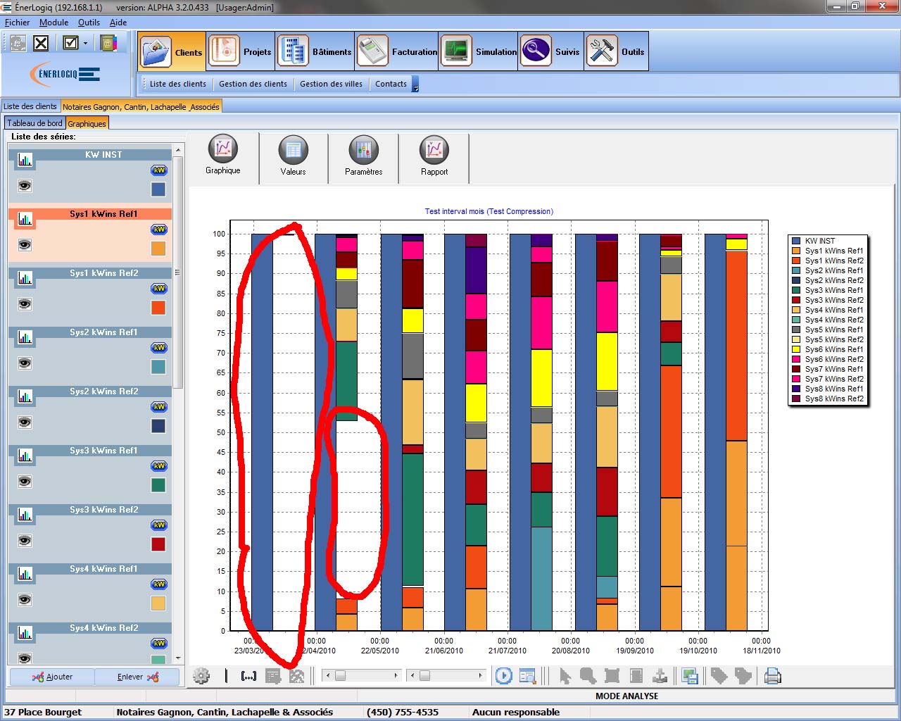

I think i got a lil bug here with the BarSeries in stack mode.
Stacked 100% with 2 groups
Stacked with 2 groups

First of all please bear in mind that for using stacking all series need to have the same number of points and same X values. Having that in mind, does this also occur using v8.07 which is the latest build available at the client area? If the problem persists can you please attach a simple example project we can run "as-is" to reproduce the problem here?

Oh ok, ill check the points count but for im sure all X Values are the same.
I dont have time right now to move to 8.0.7 because i had to change some stuff in your code to make it work like i need it (ex: DATA :Pointer; in a Series to keep tracks of lots of information)

Ahhhh, i confirm that 2 of my series didnt have the same amount of points.
