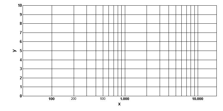

I draw additional labels to the bottom axis using BottomAxis.DrawAxisLabel.
The attached picture shows the labels 200 and 500 added.
Now I want the custom labels to get the same format as the default labels from the bottom axis.
How can I set the properties for the custom labels (f.e. font style, font size, ...)?

Hi Heinz,
I'm afraid you have to assign the properties you want to the Canvas before calling the DrawAxisLabel method. Something like this:
var val: Double;
  val:=250;
  Chart1.Canvas.Font.Style:=Chart1.Axes.Bottom.LabelsFont.Style;
  Chart1.Canvas.Font.Color:=Chart1.Axes.Bottom.LabelsFont.Color;
  Chart1.Canvas.Font.Size:=Chart1.Axes.Bottom.LabelsFont.Size;
  Chart1.Canvas.Font.Name:=Chart1.Axes.Bottom.LabelsFont.Name;
  with Chart1.Axes.Bottom do DrawAxisLabel(CalcXPosValue(val), PosAxis+TickLength+2, 0, FloatToStr(val));

Hello Yeray,
that was the missing link.
