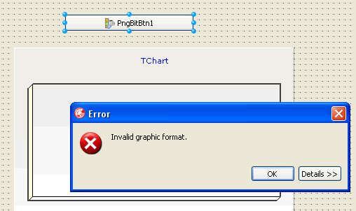

After I updated my 2010 evaluation for Delphi XE to the latest update I cannot assign a png image to any of the PngComponents from the designer (I get an invalid graphic format error). If I do not load TChart Components everything works ok... Can anybody please give me some hints on how to make this work as a lot of errors suddenly appeared with this update and this is most annoying :(

If I disable TeeMaker package and create a new VCL project and add aTPngBtiBtn, then I can add a png image to a . If I then add a TChart component I can no longer add a png image (Get that invalid format error)

The problem is not with TChart but with TPngBitBtn! I cannot assign a png to TPngBitBtn any more so I was hoping you could give me some hint (remember it worked ok with the evaluation version)
