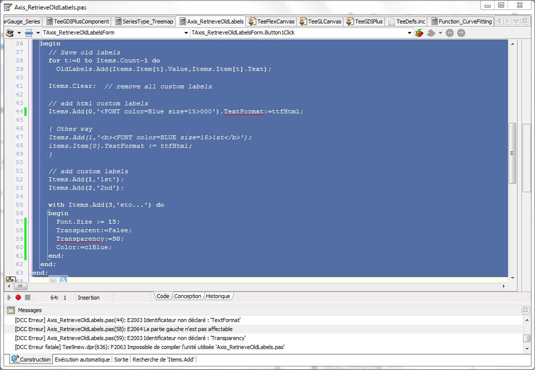

Hi Narcis,
My version is 2010.01.11004 but the project Tee9New.dpr don't is not compiled. For example this procedure failed to compile with errors as you see on the screenshot join
procedure TAxis_RetrieveOldLabelsForm.Button1Click(Sender: TObject);
var t : Integer;
with Chart1.Axes.Bottom do
// Save old labels
for t:=0 to Items.Count-1 do
OldLabels.Add(Items.Item[t].Value,Items.Item[t].Text);
Items.Clear; // remove all custom labels
// add html custom labels
Items.Add(0,'<FONT color=Blue size=15>000').TextFormat:=ttfHtml;
var t : Integer;
// Save old labels

- Capture1.JPG (121.02 KiB) Viewed 10173 times

I can compile and run the demo in the v2010.01 installer both in Delphi 2010 and XE without errors.
Could you please check that you have the TeeChart library paths in the top of the lists?
I see that both TextFormat (TTeeCustomShape) and Transparency (TTeeShape) were already present in v2010.00.

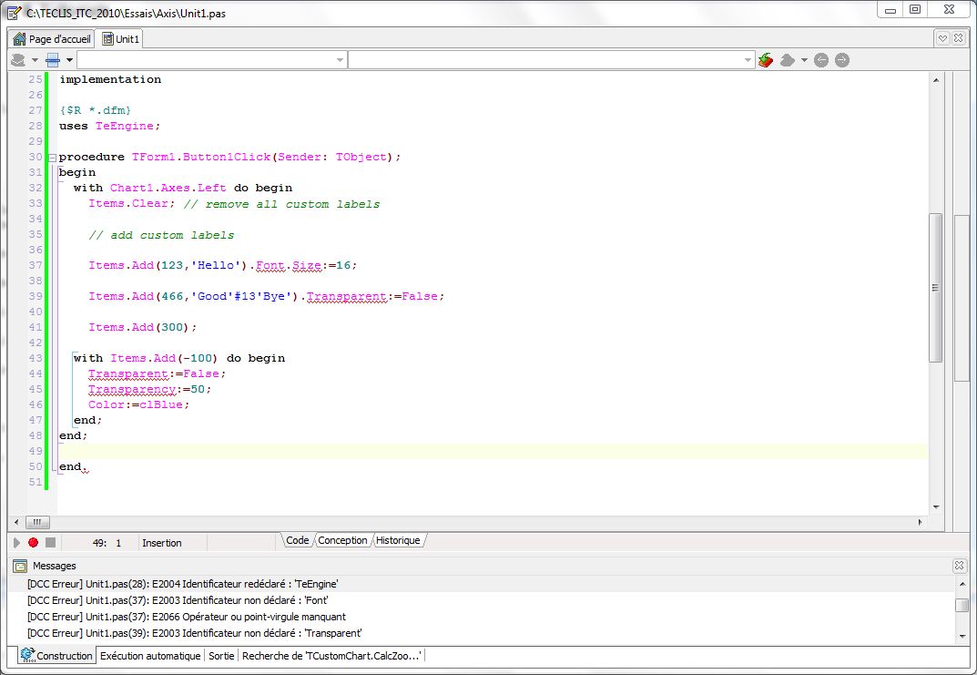

Re: Tee9New example don't work under Delphi 2010 or XE
Hi Yerai and Narcis,
I don't understand the TaxisItem class:

Delphi says that TextFormat and Transparency are not property frm TaxisItem class. It seems that it is good. My TeEngine.pas is perhaps not the good one?
Best regards and thanks for your help
Gérard.
I join a sample program where the example don't work.
Best regards
Gérard.
Best regards
Gérard.
- Compiler answer
- Capture2.JPG (101.33 KiB) Viewed 10117 times

Gerard Esposito
I find the problem. The TAxisItem has a property name Format and this proerty has transparency font...
The example has to be rewritten in
In the Tee9new project I find others problem:
TGDIPlusFontQuality=(gpfBest, gpfDefault, gpfClearType, gpfNormal);
var t : Integer;
// Save old labels
Items.Add(0,'<FONT color=Blue size=15>000').Format.TextFormat:=ttfHtml;

with Items.Add(3,'etc...').Format do
Font.Size := 15;
Transparent:=False;
Transparency:=50;
Color:=clBlue;
