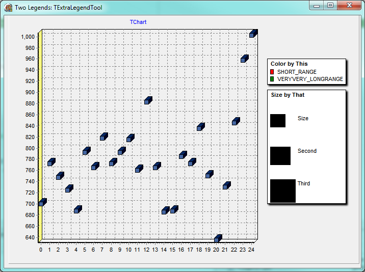

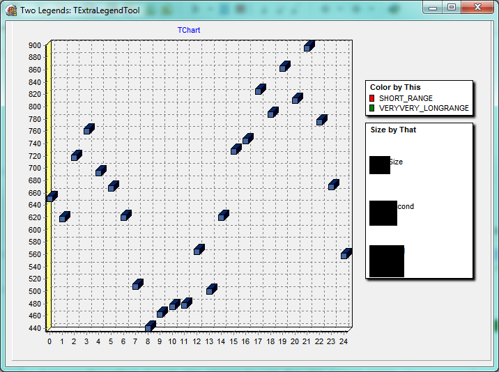

My application needs to display a second legend using a TExtraLegendTool. For each legend item, the symbol will be a different sized square which will correspond to the point size of that data item as drawn on the graph. My problem is that when I get the symbols the way I want them, the legend item text is covered up by the symbol.
For example:
I would like the text to adjust to the right, more like this :
Other than artificially padding the left hand side of the text with spaces, how can I convince the text to move over far enough to not be overwritten by the symbol?

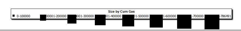

Is there any way that I could configure a relatively sized legend that is not a TExtraLegendTool and is aligned to the bottom of the chart? The code I have now for a default, bottom aligned legend with various sized rectangles overwrites both the text and the boundaries of the legend panel. Here's a picture of what I mean:
You could use custom symbols doing something as in the All Features\Welcome!\Miscellaneous\Legend\Symbol OnDraw example at the new features demo, available at TeeChart's program group.

I was already leveraging the Chart.Legend.Symbol.OnDraw event to create the differently sized squares. I have also overloaded the Chart.OnGetLegendText event to customize the strings displayed next to each of the sized symbols. I was not able to get these events to produce the look I wanted without calculating an amount of 'padding' I needed to add to the right-side of the text to force enough space for the symbol. That is okay, because we did get the legend looking really nice - mostly thanks to the super component you all provide!
