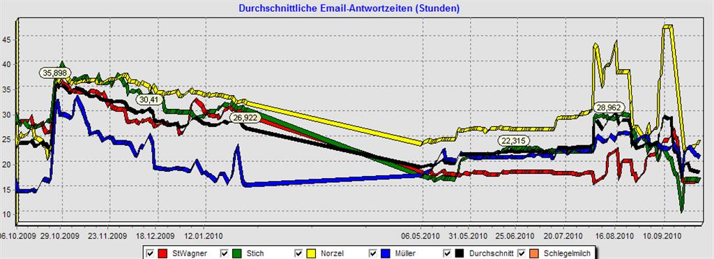

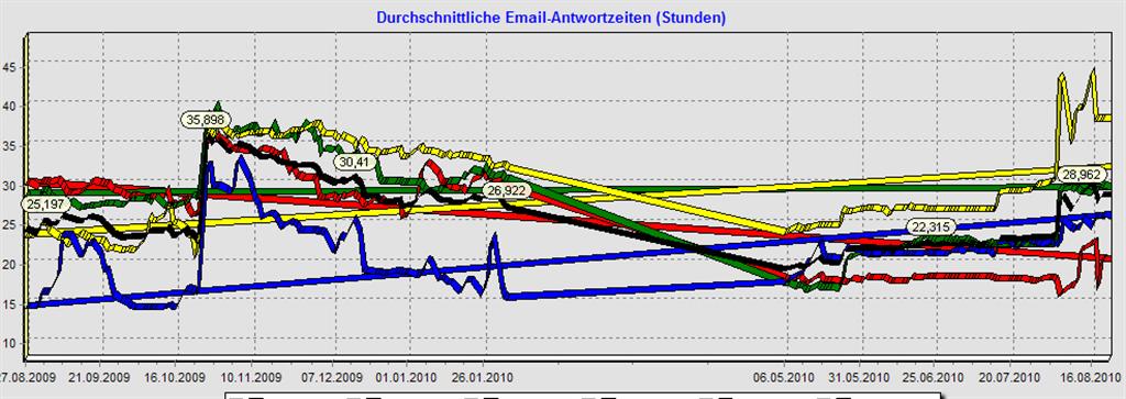

I have a DBchart that includes some datasource related graphs plus one, that uses the average function (black, german legend entry: "Durchschnitt").
When I resize or scroll the chart, odd lines, straightly connecting the first and the last points of the datasource related graphs show up (shot2.jpg).
This behaviour does not occur, when the average graph is diabled (with the checkbox in the legend) so it seems to be related with the average graph.
Any idea how to stop this?

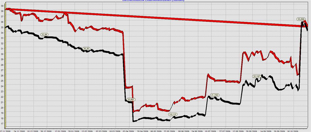

after resizing and filtering: shows diagonal for the red dataset graph
shot3 (Large).jpg (90.73 KiB) Viewed 5879 times
after horizontal scrolling: straigth diagonals connect first and last points of (coloured dataset graphs)
shot2 (Large).jpg (83.5 KiB) Viewed 5848 times
shows the usual graph
shot1 (Large).jpg (80.52 KiB) Viewed 5836 times

Found it: In "Format->Stacked" of the average chart, "overlapping" was chosen. After changing it to "none", the diagonal lines dissapeared.
