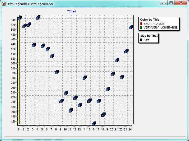

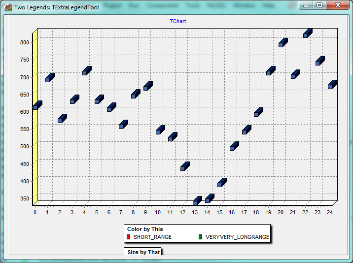

Narcís, hello!
Thank you for the suggestion to use TExtraLegendTool! I was able to make a small project that does exactly what I need and am confident I'll be able to translate what I've learned about TExtraLegendTool into my main program. I do still have a couple of questions about legend alignment, if you would be take a look at those questions, I would appreciate it!
When I have the two legends right aligned, I would like both of the legends to be the width of whichever legend is larger. In the case below, I would like "Size by That" to be the same width as "Color By This." (Note that this is just an example & the legends don't actually correspond to the points in the series). If the legends are aligned at the bottom, is there a way to get the chart to resize so that both legends are completely visible? In the image below, the "Size by That" legend is cut off. Thank you!

Re: Multiple Legends with Chart Draw Event Overrides
Hi erzsebet,
Yes, code below works fine for me:When I have the two legends right aligned, I would like both of the legends to be the width of whichever legend is larger. In the case below, I would like "Size by That" to be the same width as "Color By This." (Note that this is just an example & the legends don't actually correspond to the points in the series).
Chart1.Draw;
ChartTool1.Legend.CustomPosition:=True;
ChartTool1.Legend.Left:=Chart1.Legend.Left;
ChartTool1.Legend.Top:=Chart1.Legend.ShapeBounds.Bottom + 10;
ChartTool1.Legend.Width:=Chart1.Legend.Width;
ChartTool1.Legend.ShapeBounds.Right:=Chart1.Legend.ShapeBounds.Bottom;
procedure TForm1.Chart1GetLegendRect(Sender: TCustomChart;
var Rect: TRect);
Rect.Right:=Chart1.Legend.ShapeBounds.Right;
Yes, you can change panel margins, for example:If the legends are aligned at the bottom, is there a way to get the chart to resize so that both legends are completely visible? In the image below, the "Size by That" legend is cut off.
The attachment TwoLegends_Bottom.PNG is no longer available
Chart3.MarginBottom:=15;

Narcís, hello -
Thank you for the code snips!! I am now able to get the legends to be the same width and also to change the chart margins so that the legend is not truncated if it aligned to the bottom. In my sample code, I am calculating the Chart's MarginBottom in the FormShow event. Is there a particular TChart event where this calculation can/should be placed?
Here is my version of OnGetLegendRect event to get the effect I wanted. Here is the relevant code:
Thanks!!!
-erzsebet
