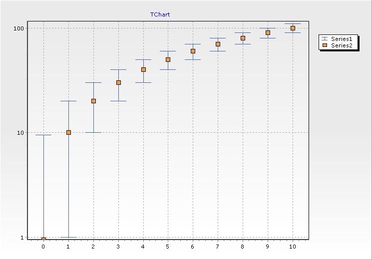

Ok, I see. That was just a step beyond TV52014260. So I have already fixed this issue (TV52015184) for the next maintenance release. I can send you ErrorBar.pas with the modifications so that you can test it at your end. Using this code snippet:
var i: Integer;
  Series1.ErrorStyle:=essTopBottom;
  Chart1.Axes.Left.Logarithmic:=True;
  //Chart1.Axes.Left.Inverted:=True;
  Chart1.AddSeries(TPointSeries.Create(Self));
  for i:=0 to 10 do
    Series1.AddErrorBar(i, i*10, 10);
    Chart1[1].AddXY(i, i*10);
I get this chart:
Is this what you expected?

Thanks for the news. The TChart plot you show for TV52015184 (longer error bars on botton) looks perfect. When will the revised version with the 3 bug fixes be available?
