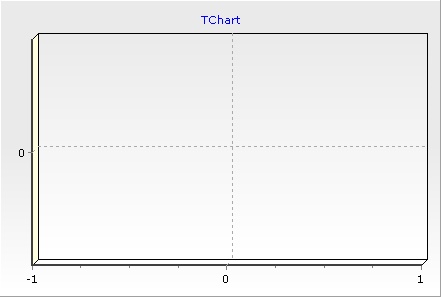

Please note the bottom axis text values. All values are correct except what should be "0" is displayed as some very small number. Is there any way to fix this?
Note Bottom Axis "0" value

Create a chart with a left axis and bottom axis. Set the bottom axis minimum to -1.0, set the bottom axis maximum to +1.0, turn bottom axis automatic to off. Do not load data. This should duplicate what I have shown in the JPEG without the data series. Is there any way I can access the axis text to make changes at runtime?
That is using line below, which works fine here both in v8 and v2010. v6 is pretty old and many bug fixes, enhancements and new features have been implemented since.
	Chart1->Axes->Bottom->SetMinMax(-1, 1);
With this line and adding a series at runtime without populating it I get this chart:
Yes, using the events I told you in your other post. Have you tried using them? Do you have any problem with those events? You'll find more information on how to use them in tutorial 4. Tutorials can be found at TeeChart's program group or at installation Docs folder.
