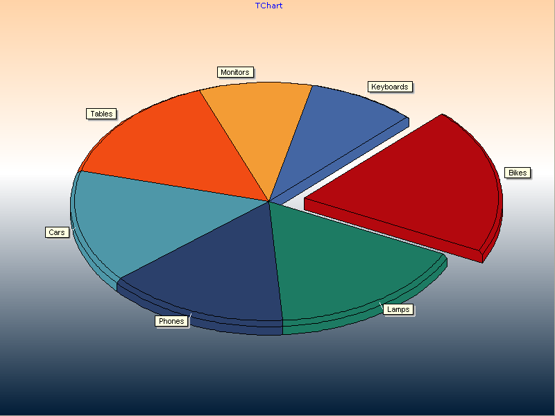

I've attached my result.
As you can see your image has some differences:
1. Lines between pie's slices has the same color as the slice itself.
2. Lines and color are more smooth.
3. The image has some effects (lighting, gradient or filter)
And I've found the same post at ActiveX forums Pie Chart Drawing.
Can you give me the sample of source code (for Delphi7) so that we can make such effects.

This example in the gallery was created using TeeChart for .NET so there will be rendering differences between VCL and .NET versions of TeeChart. However, TeeChart 2010 has been improved to plot similar charts as you can see at the "What's New?\Welcome!\New in Series\Pie Lighting" example in the new features demo available at TeeChart's program group.

However, it brought us a serious problem. The chart window is contained in a DLL which is being used from under the Microsoft Word. Once we load this chart the winword process gets the gdi+ thread which never disappears. Closing Word after that will always freeze the winword window. If we do not use charts, then Word closes correctly.
Please adwise the correct way of using the GDI+ with charts so that it does not freez MS Word.

Sorry for the delay. We found this problem before when preparing TeeChart 2010 ActiveX Beta. This is in the bug list with number (TV52015196) and we just fixed it for the VCL version as well. We will send you a test version next week. Could you please, confirm the Delphi version you use?
