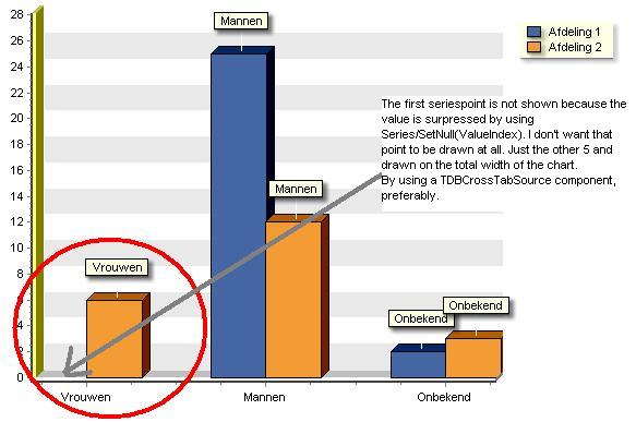

I have a dataset and want to remove/surpress 0 values.
What I am using and need is a TDBCrossTabSource for showing summaries in a chart.
Sometimes a record can contain a 0 value and I like to be able to leave them out of the chart before the specified seriespoint is drawn. By filtering the dataset on records with a value greater then 0 I get less records already. The TDBCrossTabSource component creates series but seems to need an equal number of records to create those series. And is automatically drawing those 0 zero based points. If I use this for example : Series1.SetNull(ValueIndex), then the seriespoint isn't shown but the layout of the chart becomes a bit messy I think.
How can I make sure that all points are drawn on the total width of the TChart as it is done when there are no 0 zero values?
See image attached for a screenshot what the issue/problem is.

Re: Surpress 0 or null values when using TDBCrossTabSource
Hi Eric,
I'm afraid it's not possible right now. I've added it to the wish list to be implemented in future releases (TV52015171).
Hi Eric,
What about using bottom axis MinimumOffset?
Chart1.Axes.Bottom.MinimumOffset:=-1;
Yes that will hide the first point yes. But what if I have zero point somewhere in the middle? And what in case paging is enabled?
I'm affraid this is not gone work isn't it?
Eric.
Eric.
Hi Eric,
No, it won't. If you don't want those points to be displayed at all why don't you remove them from the series?
