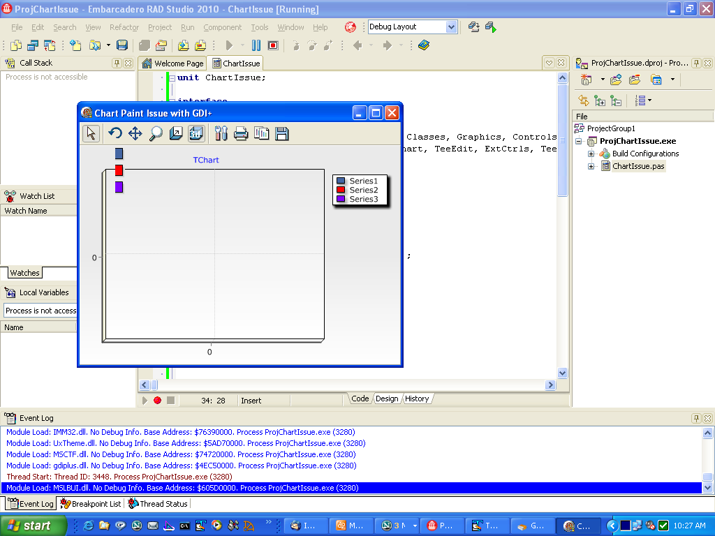

Re: Problem After Saving Chart From Tee Comander with GDI+
Hi narcis,
Sorry for the delay in responding.
I have attached a screensot and a small app that caused it.
Not sure how this fits, while away I needed to update my mobile PC, with the latest release.
While attempting to install this release(non-stable) the install failed. Trying to recompile, this also failed looking for a package/file **814. This PC did have the Pro VCL version running and all seemed well. In my panic mode, I tried uninstall all the version 9 code, then re-install only the latest, still no good. I looked and the last version 8 was 8.04, so I updated to the last version 8, then installed v9, there are still some conflicts, however I was able to compile the application I was working on.
The exe from this build would not exhibit the artifact issue. The exe attached was from a development machine that the V9 ns version installed with no problems. Maybe there is a build error causing my problem?
Mike
Itried to do the cleanup and re-install and while doing this the license activation server complained about incorrect username and password with error 3243153. So the problems are always new.
Back to the main problem with the repaints and atrifacts, it seems I did not fully understand how to produce the problem.
I clicked the Edit button on the Commander, then Closed the editor, No problem. I switched tabs, as the application has several tabs, with the Chart on a tab, came back to the tab with the chart and the artifacts appear, (the sysmbols for the chart ). if I do the same with Buffered Display not selected on 3D/ Render / GDI+ then then is not problem. With this option not selected, when you close the editor, the chart do a repaint once, you see the items painting. For the filcker you do not get the artifacts.
Mike
Hi Mike,
I could now reproduce the problem so I've added it to the defect list to be fixed asap (TV52015202).
It seems that for some reason, when you put some window over the left part of the chart, the legend symbols are repeated there.
Thanks for reporting this.
