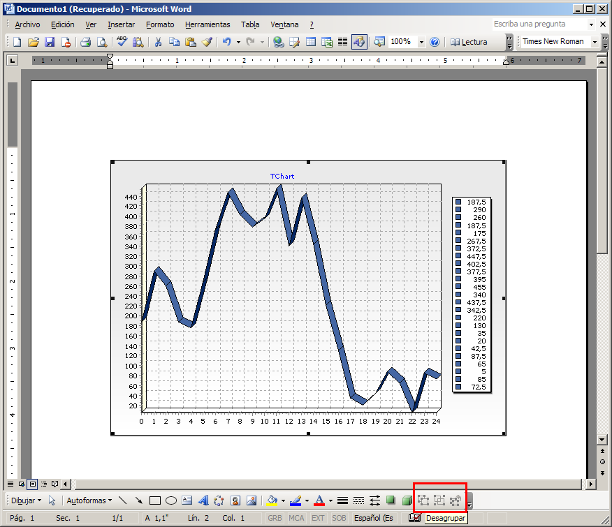

I've found the unGroup button but it is unavailable for me while the image is selected:
Word 2003.png (64.76 KiB) Viewed 7882 times
Am I doing something wrong?

We've seen that your chart seems to be pasted into some other object, maybe a TextBox?
I've inserted a TextBox and pasted the chart into it. Then, in the TextBox contextual menu (not in the Chart image contextual menu) I can see the Group submenu, but all the buttons in it are grayed.
