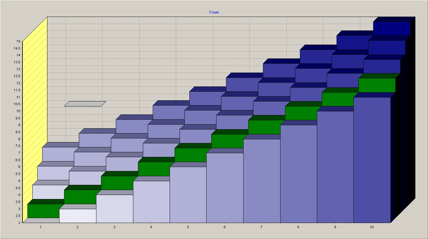

I have an application where I need to be able to show information stacked, like a multibar, but using the Z direction as well.
When I use multiple bars and select multiple stack groups, they all come out side by side on the front plane.
When I use a 3D tower, I get the ability to define values back into the Z direction, but I can't seem to get anything to stack.
What I'm after is something like 2 or more Tower series that stack on top of each other, but then I do that, I get a flat plane for the second series, as shown in the attached jpg.
In the attachment, the entry for the second series was at X=2, Z=2, Y=10, and what I'm looking for is a bar that stacks on top of the X=2, Z=2 value for the first series.
It would actually show at Y=14 because it would be 4 from the first series, then 10 for the second.
I imagine if there is a solution, it is something like multiple bar stack groups, then the ability to assign a Z depth to different groups.
Is there a way to assign a Z depth to specific series?
Suggestions appreciated
Is this something that would be better handled by purchasing a support agreement?
Hank
Graph Image.jpg (296.62 KiB) Viewed 3119 times

You can achieve something similar to what you request using TBar3DSeries and ZOrder.
uses Bar3D, Series;
const NumRows=10;
      NumColumns=10;
      StackedSeries=2;
var i, j, k: Integer;
  for i:=0 to NumRows-1 do
    for j:=0 to StackedSeries-1 do
      With TBar3DSeries.Create(Self) do
        Marks.Visible:=False;
        MultiBar:=mbNone;
        BarWidthPercent:=100;
        ZOrder:=i;
        for k:=0 to NumColumns-1 do
          if j=0 then
            AddBar(k, random, 0)
            AddBar(k, random, Chart1[Chart1.SeriesCount-1].YValues[k]);
        ParentChart:=Chart1;
With TBar3DSeries you need to the stacking manually. You may also be able to achieve something similar combining TBarSeries stacking options with ZOrder too. For example:
uses Series;
const NumRows=10;
      NumColumns=10;
      StackedSeries=2;
var i, j: Integer;
      With TBarSeries.Create(Self) do
        MultiBar:=mbStacked;
        StackGroup:=i;
        FillSampleValues(NumColumns);
        ZOrder:=i;
      end

Works perfectly.
