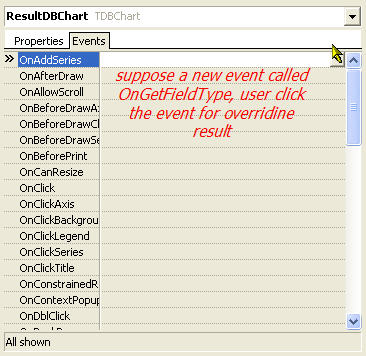

Hello
I do not suggest Oracle support only in the editors but a general support.
Considering the fact that 107 is DevArt's specific, maybe other Oracle component has other value, so for a wider range support, regardless what actual Oracle component user is using, I think expose this event out is more user friendly for easier handling as following
1. User clicked the event
2. And override the result based on his specific Oracle-supported components as
So, I am not request to expose TeeChart API out to end-user, but would rather have this event expose to software developers.
Your suggest to use a global variable of course also works, but coding is a little more complicated for a C++ user.
void __fastcall TFrorm1::DBChart1OnGetFieldType(TObject *Sender,TComponent *ASource, TFieldType *AType, TTeeFieldType &TeeType)
if ((Integer)AType==[107 or other value, which is whatsoever component's specific to represents its Oracle Number type])
TeeType=tftNumber; //<--- user override result here
- a new event fired for datatype for user to override
- pic1.jpg (35.9 KiB) Viewed 7610 times
Re: Support Oracle ftNumber type
