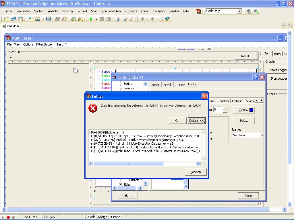

1:
Crash when selecting font tab in the chart editor.
The different fonts can be changed with the Delphi Object Inspector without problems.
See attached screen shot.

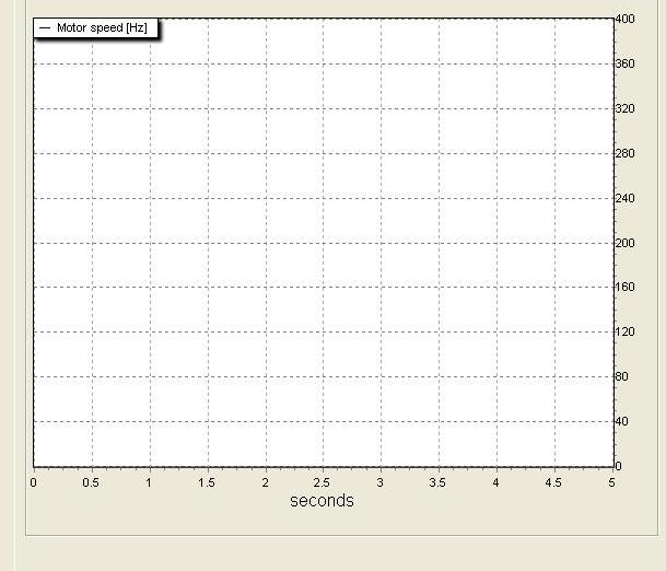

2:
When showing more custom axes with the same range (min/max), the first one appears to be "shorter" than the rest.
This results e.g. in grid lines not being positioned perfectly on top of each other.

1:
2:

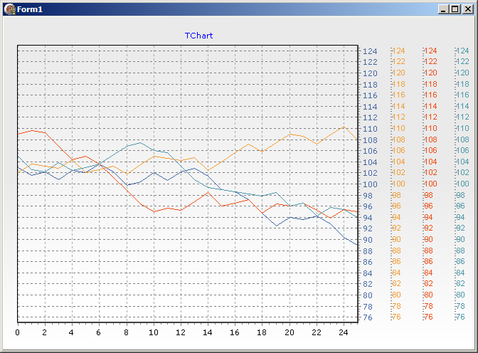

Re: More custom axes with same min/max are not drawn equally!
Hi ChartIt,
So maybe you are setting a different SetMinMax to one axis and the others?
Please, try to change the code above so the problem can be reproduced here, or arrange a simple example project for the same purpose.
This is a known problem we've already fixed for the next maintenance release (TV52014813)ChartIt wrote:1:
I'm trying to reproduce it with the following code but the grid lines are well aligned.ChartIt wrote:2:

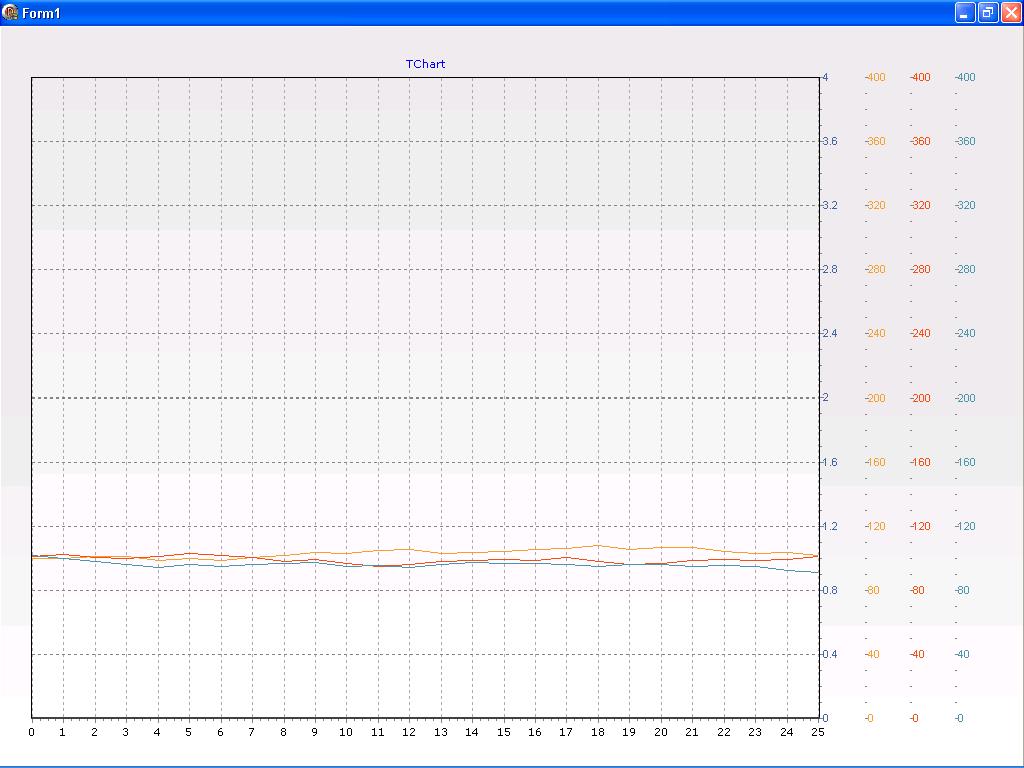

Thanks for your reply.
With this code you should be able to see the issue:
var i, j: Integer;
Chart1.View3D:=false;
Chart1.Legend.Visible:=false;
for i:=0 to 3 do
Chart1.AddSeries(TFastLineSeries);
Chart1.Add(Random(10) + 100);
for j:=1 to 25 do
Chart1.Add(Chart1.YValue[j-1] + Random(5) - 2.4);
if (i = 0) then
Chart1.CustomAxes.Add;
Chart1.CustomVertAxis:=Chart1.CustomAxes;
Chart1.CustomVertAxis.OtherSide:=true;
Chart1.CustomVertAxis.PositionUnits:=muPixels;
Chart1.CustomVertAxis.PositionPercent:=-i*45;
Chart1.CustomVertAxis.Axis.Visible:=false;
Chart1.CustomVertAxis.SetMinMax(0,4);
Chart1[i].CustomVertAxis.LabelsFont.Color:=Chart1[i].Color;
Chart1[i].CustomVertAxis.Increment := (Chart1[i].CustomVertAxis.Maximum - Chart1[i].CustomVertAxis.Minimum)/10;
end
Chart1[i].CustomVertAxis:=Chart1.CustomAxes[i];
Chart1[i].CustomVertAxis.OtherSide:=true;
Chart1[i].CustomVertAxis.PositionUnits:=muPixels;
Chart1[i].CustomVertAxis.PositionPercent:=-i*45;
Chart1[i].CustomVertAxis.Axis.Visible:=false;
Chart1[i].CustomVertAxis.SetMinMax(0,400);
Chart1.MarginRight:=20;
When making the Chart big you should see a double grid line, this time in the middle (at 2/200).
Could it be a rounding issue when I'm calculating the Increment?
Hi ChartIt,
I can't see the double grid line you mention, even with the chart maximized or zooming.
Anyway, you can hide all the grid lines except of one of them. Here it is the example:
http://www.teechart.net/support/viewtop ... sor#p29360

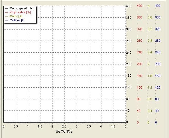

1:
See enclosed screen shot with my example.
Hiding the grid lines only solves the problem visual, but not the fact that the axes might be scaled different.
Hi ChartIt,
If you still have troubles with it, don't hesitate to let us know.
Here it is the project in Delphi 2006 + TeeChart v2010 that works fine for me here. Anyway, as you said, a pixel difference could be because of a rounding that has to be done when passing from values (doubles) to pixels (integers). I think there isn't too much we can do here apart from hiding grids.ChartIt wrote:1:
Yes, this is a known issue already in the wish list to be revised in future releases.ChartIt wrote: 2:
