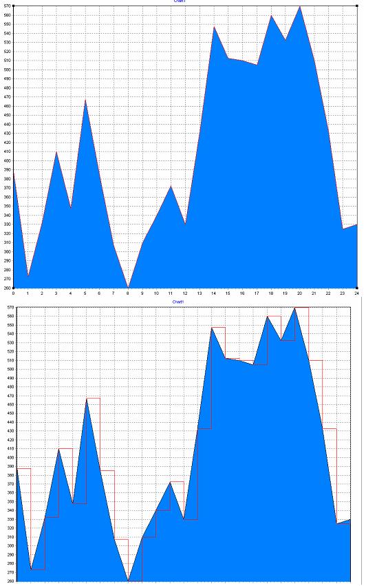

using the Region Tool with LineSeries works well, but when switching to LineMode Stairs the area under the line is not filled correctly:
Region Tool.JPG (77.8 KiB) Viewed 3979 times

Hi Heinz,
I've reproduced it and added it to the defect list to be fixed in future releases (TV52015103).
Thanks for reporting it. In the meanwhile you could try using TSeriesBandTool that works fine with Stairs.

Hi Heinz,
Just wanted to let you know that TV52015103 has been fixed for next TeeChart Pro 2010 VCL maintenance release.
