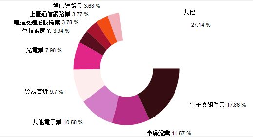

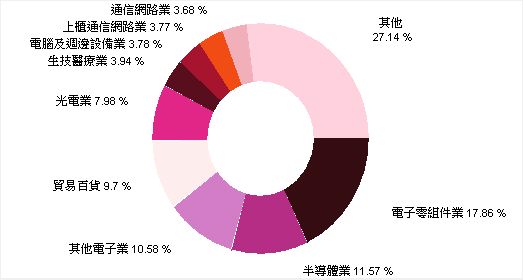

I have re-compiler with teechart 2010 VCL as you write in
http://www.teechart.net/support/viewtop ... =3&t=11472
But another problem happened.
I have connect donut chart with TTeeGDIPlus.
if I set TTeeGDIPlus.active := false , the donut chart(BeforeGDIPlus.jpg ) seems ok.
But when I set TTeeGDIPlus.active := true, strangle angle happens again.(AfterGDIPlus.jpg).
Daniel

Post by Yeray » Mon Aug 23, 2010 1:40 pm
Hi Daniel,
I could reproduce it in the latest sources, but also with the latest published release. Can't you reproduce this problem with it?
anyway, I've added it to the defect list to be fixed asap (TV52015101).
