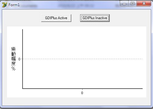

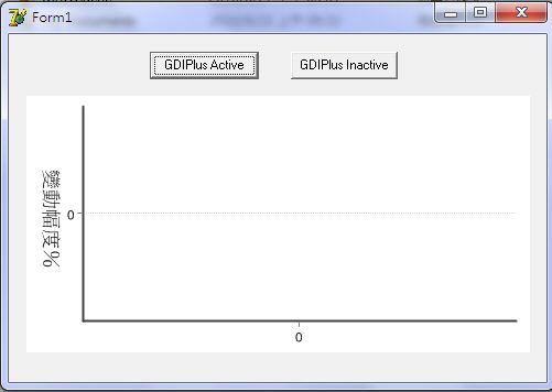

Re: Questions about TeeChart VCL 2010
Hi Yeray:
if I set left axis title's angle is 270 degree and title's font to @微軟正黑體 and GDIPlus.active:=false.(Press GDIPlus Inactive Button)
The title of left axis of chart1 is what I want.(Inactive.jpg)
But If you press GDIPlus active Button, the title of left axis of chart1 is changed.(active.jpg)
How can I set GDIPlus.active:=True but don't change the left axis title of chart1?
Picture and Sample code as attached.
Daniel
Daniel
- active.jpg (17.46 KiB) Viewed 10061 times
- Inactive.jpg (18.11 KiB) Viewed 10060 times
- Sample.zip
- (416.73 KiB) Downloaded 793 times
Hi Daniel,
I'm afraid this is a bug, which I have added to the defect list (TV52015108) to be fixed in future releases. The only workaround I can think of for now is not using GDI+ canvas.
