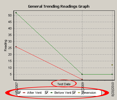

This is the screen shot of the issue I am having.
The axis title and the legend are not shifted relative to the height of the labels, or maybe rather the chart area is not shifting leaving enough margin for the title and legend not to overlap.
My code still remains the same as mentioned above with the addition of what you described for the talText setting and the GetAxisLabel code.

The issue was with not having any Series created on FormCreate.
Adding series later on (on ShowTab) was not formatting the chart properly.
I had to create a dummy series, I actually did it through the Chart Editor, which is assigned to a DataSet and holds X/Y values but is manually hidden from displaying anything.
That corrected the formatting.
Issue solved.
Re: Undesired effect from code added values to TLineSeries help!
Post by Yeray » Tue Aug 24, 2010 4:28 pm
Hi Marcin,
Once the axes labels are formatted with OnGetAxisLabels event, the margin and the position where the axis title has to be drawn isn't calculated so you have to do manually.
This is a very similar case to the thread mentioned above, where a new LabelStyle would avoid you to do all these manual calculations (TV52015098/TF02015095).
In your case, you also need an axis title and the position where the axis title has to be drawn isn't accessible so I'll suggest you to use an AnnotationTool to draw the axis title where you've calculated.
Here it is an example:
