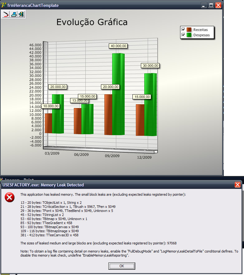

I'd removed the line IXORCanvas:=TTeeCanvas3D.Create from InitWindow and put in the Constructor Create and trouble keep on.
What should I do now? Any solve else?
I'd sent a print screen from MM4.
thanks
print screen of the Application and MM4

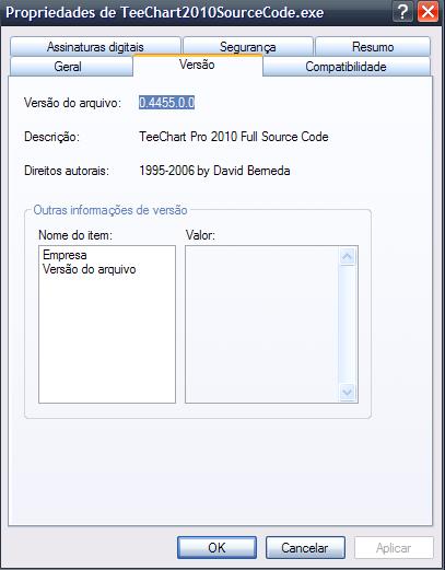

I´m using the >>>TeeChart Pro 2010 Full Source Code >>>Version 0.4455.0.0 and like you can see the Memory Leak keep on. Have you see the atachment file (print mm4) wich I sent you?
properties of the release
FileTeeChart2010SourceCode PROPERTIES.JPG (27.22 KiB) Viewed 7577 times
