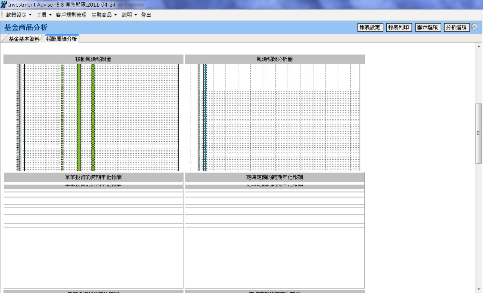

Hi:
Pls. see the attached images.
After I change from Teechart 7 to Teechart 2010.
Using Teechart 2010, The charts become very strange after pull down scroll bar.
But this program works fine by Teechart 7.
How do I solve this problem?

- After pull down scroll bar
- AfterSelect Options.PNG (288.59 KiB) Viewed 10601 times

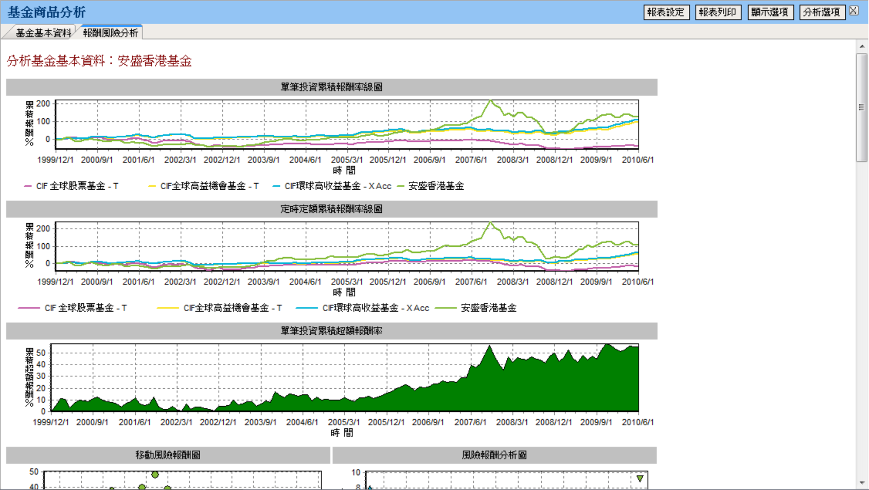

- Before pull down scroll bar
- BeforePicture.PNG (188.49 KiB) Viewed 10555 times

Hi Daniel,
You could try calling Draw() method at your ScrollBar OnChange event.
Also note that we've introduced some changes to the internal repainting for maybe related reasons, so this could fix you problem in the next maintenance release:
http://www.teechart.net/support/viewtop ... =3&t=11250
If you can send us a simple example project we can run as-is to reproduce the problem here, we'll try it in the latest sources so we can tell you if the next maintenance release will fix it or not.
