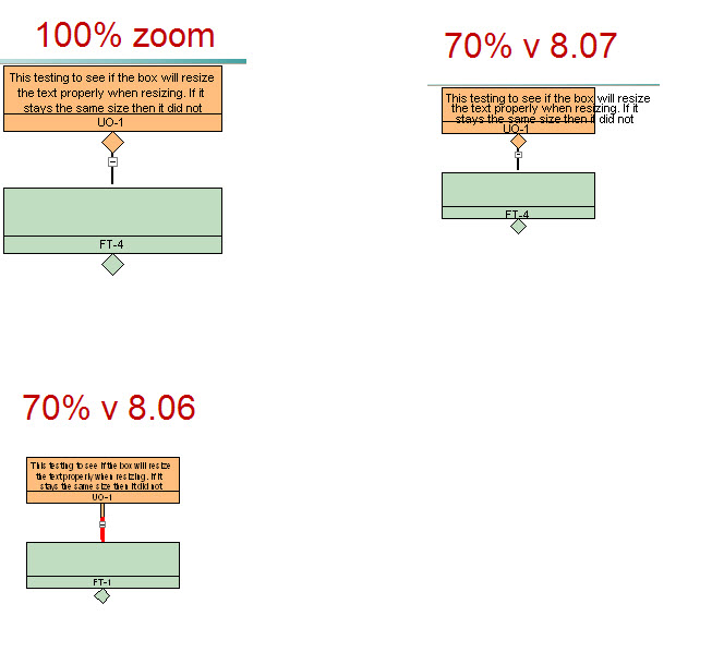

I have an application and we recently upgraded to Delphi 2010, I updated TeeChart from 8.06 to 8.07. Now the text in the TreeShape when I draw a TTree no longer resizes when the .View3DOptions.Zoom is changed.
Any suggestions on why this happens? No code changes have been made, so is there a new setting or property I am failing to set now?

Text no longer resizing with zoom change in vers 8.07
- zoom problem.jpg (65.55 KiB) Viewed 7599 times

I tried the following but it didn't work. Do you know the problem, we purchased the Source Code, and if you can give me a fix I might be able to get it working in the TeeChart source. We are trying to get a new release out that works for Windows 7.

The code you proposed doesn't work because the OnChangedZoom event is checked before changing the Zoom internal value. At TeCanvas.pas, if you change the method:

The size of the font changed at OnZoom event should work fine.
