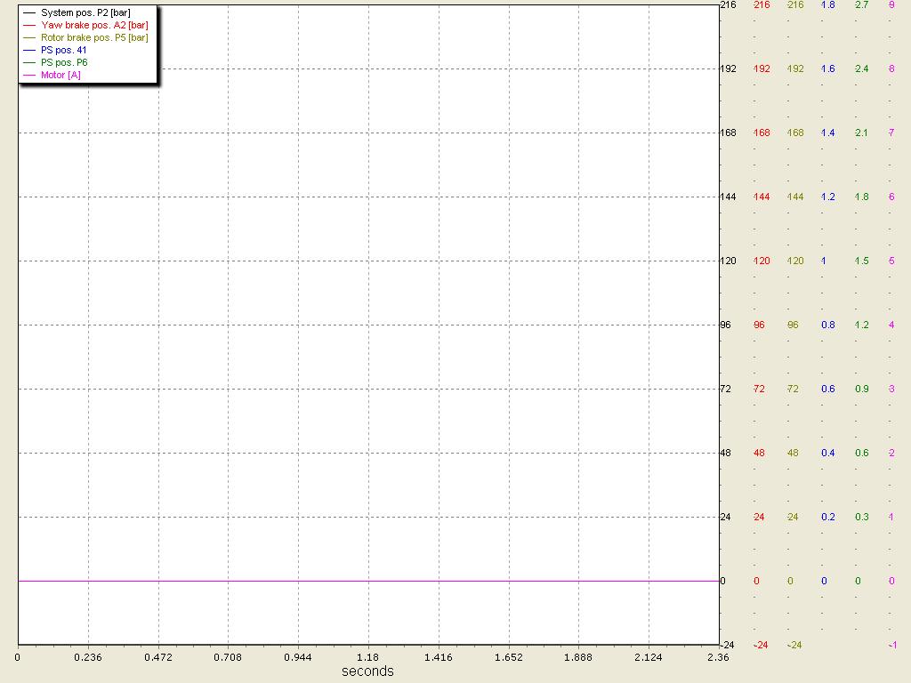

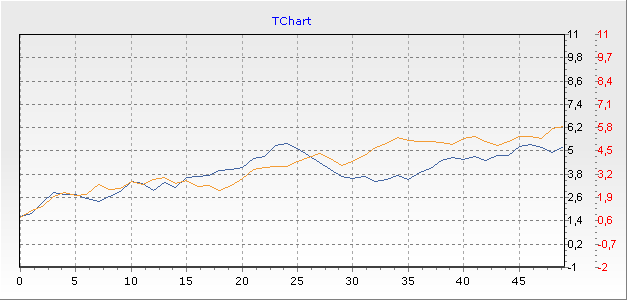

I have two custom axis as seen on the enclosed screen shot.
If the axis scale is set from -1 to 11 (as the first custom axis), everything is displayed OK.
If the axis scale is set from -2 to 11 (as the second custom axis), the lowest label disappears!
Here is the relevant code:
for i := 1 to 2 do
Chart1.Axes.Items[i+5].SetMinMax(frmGraphSettings.ViewScaleFrom, frmGraphSettings.ViewScaleTo);
Chart1.Axes.Items[i+5].Increment := (frmGraphSettings.ViewScaleTo - frmGraphSettings.ViewScaleFrom)/10;
Chart1.Axes.Items[i+5].RoundFirstLabel := False;
Do I do anything wrong, that causes the lowest label to disappear??

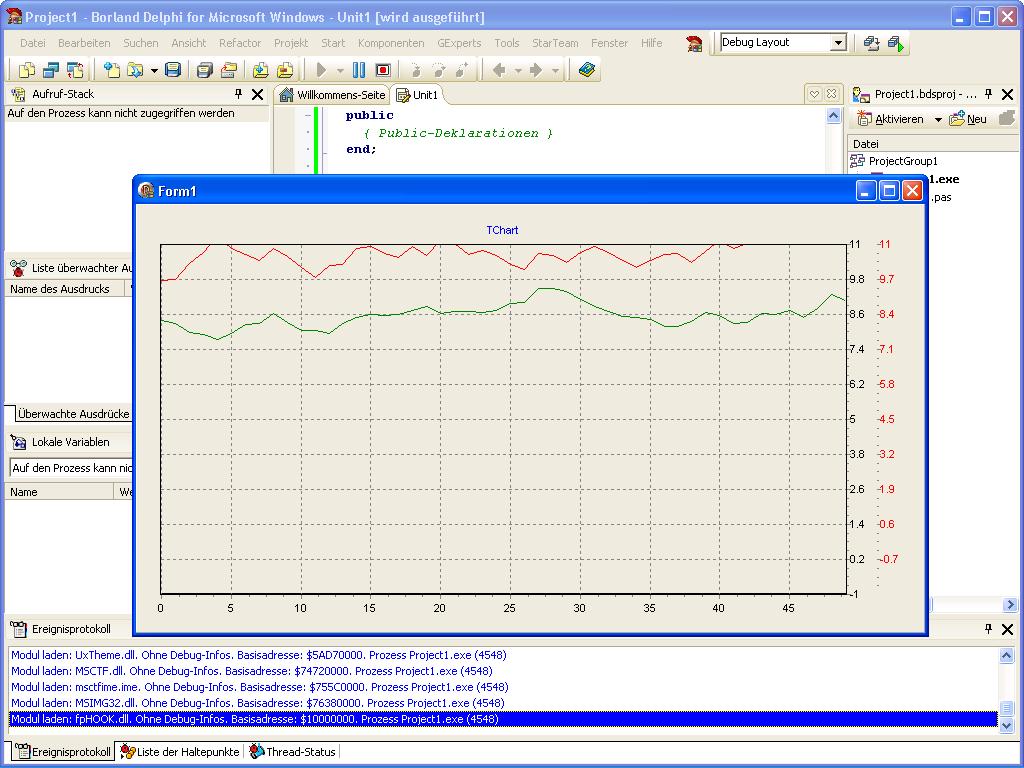

Post by ChartIt » Tue Jul 27, 2010 8:58 pm
I get the same bad result when trying your code.

Re: Lowest axis label disappears
Post by Yeray » Thu Jul 29, 2010 8:54 am
Hi ChartIt,
I've reproduced the issue in a system like yours and I can confirm that the latest TeeChart VCL v2010 works as in the picture I showed you before.
You can try it if you want: http://www.steema.com/evaluation/vcl
In v7 I've also seen that playing with the MinimumOffset you could work around this:
Chart1.CustomAxes[1].MinimumOffset:=1;

It now seems like the label disappearing problem has been reintroduced (see screen shot).
What's going on??
Lower label.JPG (69.77 KiB) Viewed 7982 times

First, I've ran the project I proposed above and noticed nothing irregular.
Then I saw in your picture that you've changed the axes minimum and maximum, and , after trying the same than you, I could reproduce the problem.
uses Series;
var n: Integer;
  Chart1.Align:=alClient;
  Chart1.View3D:=false;
  Chart1.Legend.Visible:=false;
  Chart1.MarginLeft:=20;
  for n:=0 to 4 do
    Chart1.AddSeries(TFastLineSeries);
    Chart1[n].FillSampleValues();
    Chart1.CustomAxes.Add;
    Chart1[n].CustomVertAxis:=Chart1.CustomAxes[n];
    with Chart1.CustomAxes[n] do
      Axis.Visible:=false;
      Ticks.Visible:=false;
      PositionUnits:=muPixels;
      PositionPercent:=-n*30;
      LabelsFont.Color:=Chart1[n].Color;
      if ((n = 0) or (n = 1) or (n = 2)) then
        SetMinMax(-24, 216)
      else if (n = 3) then
        SetMinMax(-0.2, 1.8)
      else if (n = 4) then
        SetMinMax(-0.3, 2.7);
      Increment:=(Maximum - Minimum) / 10;
      //MinimumOffset:=1;  //workaround
So it seems to be reproducible in very particular cases, and still the MinimumOffset property seems to solve the problem.
