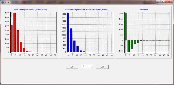

I'd appreciate some insight into why there is such a discrepancy between data binned by THistogramFunction and MATLAB's binning. The attached code uses my own method for binning (a standard method) which reproduces MATLAB output exactly. The differences are even more remarkable and disconcerting when using much larger data sets (I regularly use 70000+ raw data points), which significant consequences for statistics applied to the binned data. The differences between these methods are not just manifest at the beginning of the distributions, but appear throughout.
Clearly I'd like to discover that I'm doing something fundamentally wrong in my use of THistogramFunction which, if rectified, would match manual/MATLAB binning, but I'm not confident that this is where the problem lies. At the moment this is a major problem and cause for concern; any help would be very much appreciated indeed.

The source of the discrepancy is in the binning algorithm of TeeHistogram.pas. In
the use of Round() function seems to me to be inappropriate. Round() probably uses Banker's rounding which means odd and even numbers are treated differently. Replacing Round() with Trunc() has the desired effect, making the values compatible with C/C++, MATLAB etc. Thus:
I'm also not convinced of the use of 0.5 in setting bin centerpoints a few lines above in the same file. Using
gives more intuitive results (others may disagree, and my impression may just be contextual).

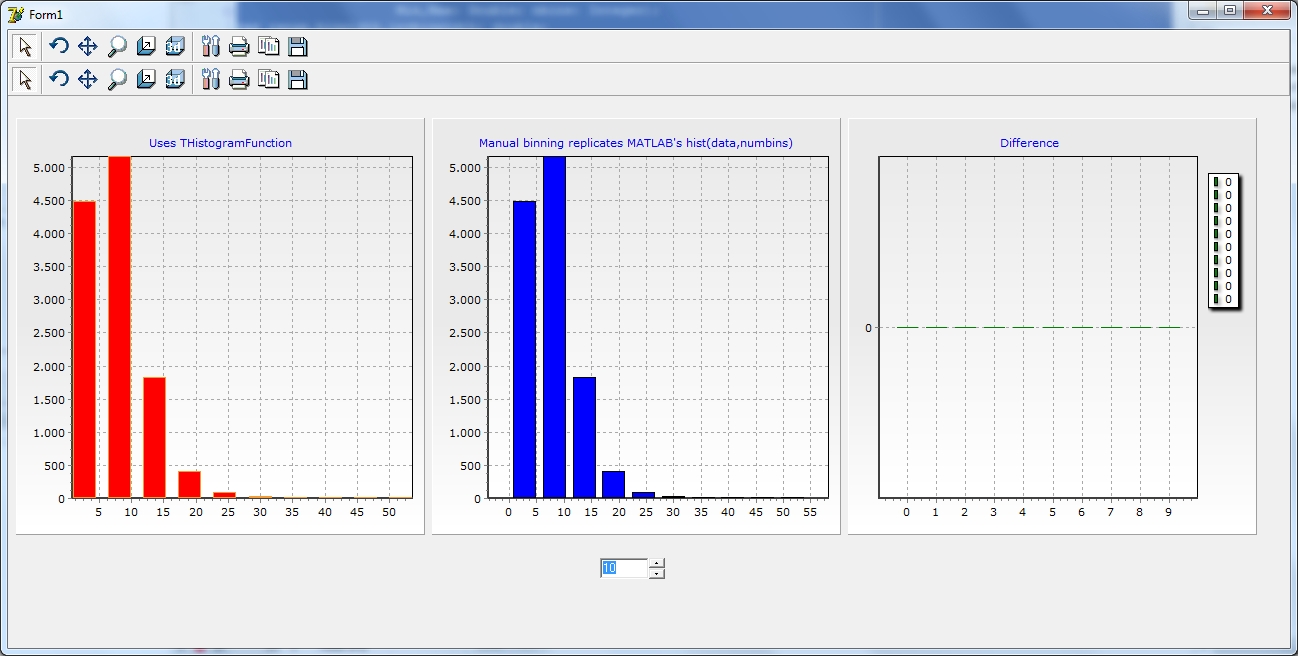

- using Trunc()
- trunc.jpg (57.27 KiB) Viewed 19051 times
- using Round() - the difference is obvious
- round.jpg (59.73 KiB) Viewed 19039 times

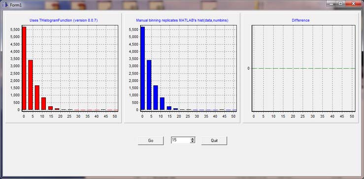

I attach a Delphi example, similar to yours, which I created to be able to easily debug sources and which produces this chart:
Thanks for your feedback.
Yes, that's correct, see Delphi's Round method documentation.the use of Round() function seems to me to be inappropriate. Round() probably uses Banker's rounding which means odd and even numbers are treated differently.
It's not necessary as our current v8 and v2010 (aka v9) sources already produce same results as you'd expect. I bet this is due to a bug (TV52012772) fix which was discussed here. Actually TV52012772 was fixed for v8.07 as can be seen in the release notesReplacing Round() with Trunc() has the desired effect, making the values compatible with C/C++, MATLAB etc.

yes (RAD 2009). I was just looking at it just now. It compiles and runs fine. The THistogramFunction (left) and manual binning chart (middle) are identical, with no difference (right chart).Narcís wrote: Do you have any Delphi version for trying the project I attached and check if it works fine for you? At the URL below you can download the exe I generated with my sample project. Can you please check if it works as expected at your end?
However, the manual binning routine in
procedure TForm1.Edit1Change(Sender: TObject);
