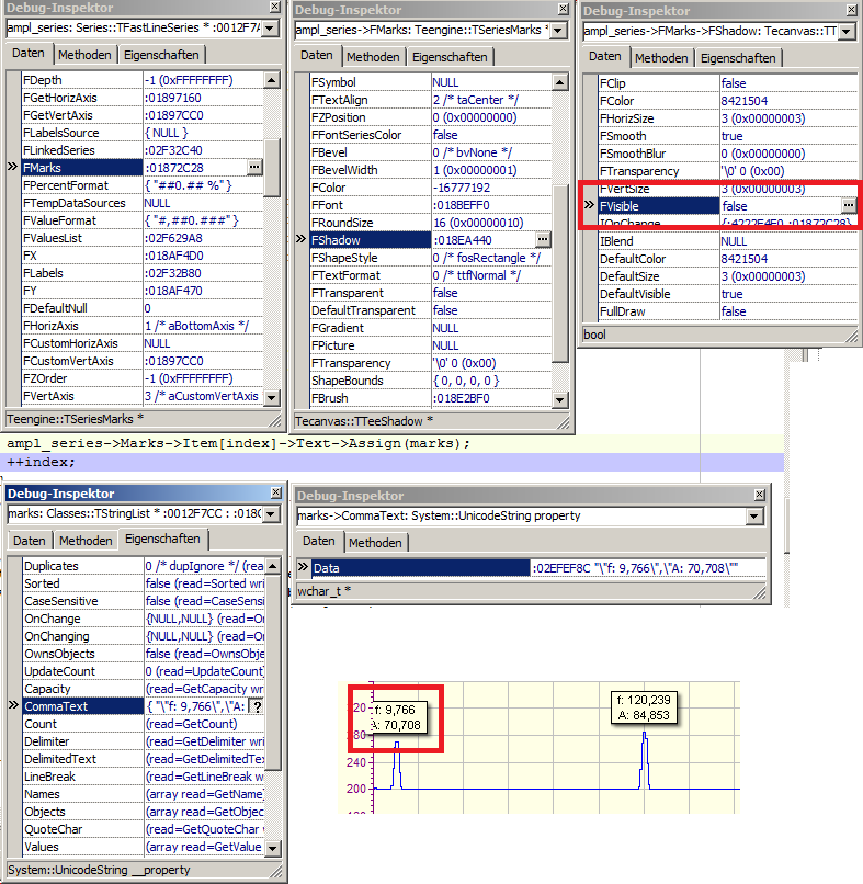

I set some colors and disabled shadow of marks of a TFastLineSeries. Did it in design time and by code. However, shadow doesn't disappear and colors are unchanged. Disabling Marks->Arrows works. How can I change the other properties?
The debugger shows, that shadow is set to false. Nevertheless it is drawn.
I wonder, if the acceleration of FastLine is responsible for not considering individual settings of marks.

Post by to2 » Thu Jul 22, 2010 2:04 pm
Here is a screenshot.
Debugger shows mark shadow invisible, but it is drawn.

Post by Yeray » Fri Jul 23, 2010 1:42 pm
Hi Thomas,
I'm not able to reproduce it with the following code:
var i: Integer;
  Chart1.View3D:=false;
  for i:=0 to 5 do
    Series1.Add(i, 'point nº' +IntToStr(i));
  Series1.Marks.Visible:=true;
  Series1.Marks.Shadow.Visible:=false;
  Series1.Marks.Color:=clRed;
Could you please modify it so we can reproduce the problem here? Or could you please arrange a simple example project we can run as-is to reproduce the problem here?

Re: Restrictions for Marks in TFastLineSeries?
Post by Yeray » Fri Jul 23, 2010 3:59 pm
Hi Thomas,
Yes, it seems that if you change a MarkItem.Text, the marks before it loose their format. I've added it to the defect list to be fixed in future releases (TV52015046).
In the meanwhile, a workaround would be to reassign the desired format to all the marks:
var i: Integer;
  Series1.Marks.Item[3].Text.Text:=('Hello');
  for i:=0 to Series1.Marks.Items.Count-1 do
    Series1.Marks.Item[i].Color:=Series1.Marks.Color;
    Series1.Marks.Item[i].Shadow.Visible:=Series1.Marks.Shadow.Visible;
