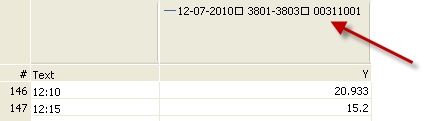

This is what I would like over 3 lines instead of one
22-07-2010 5-22-25 PM.png (3.45 KiB) Viewed 5199 times

I cound reproduce it.
I've seen that a workaround for the TCustomDrawGrid is to use OnDrawCell event as in the example bellow. But this event is defined in TCustomDrawGrid and this class inherits from TCustomGrid, and TChartGrid inherits from TCustomGrid too, so this event isn't defined.
I've added it to the wish list to be enhanced in future releases (TV52015047).
