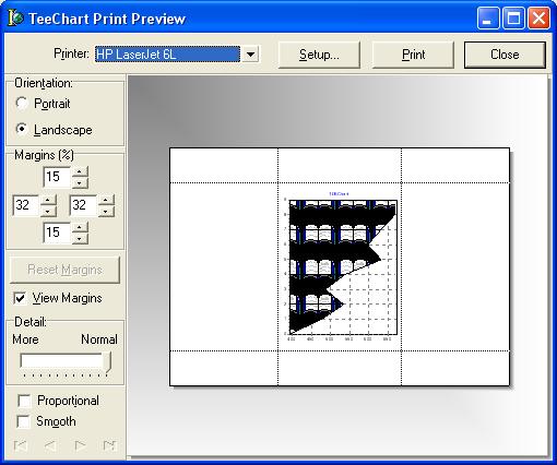

Re: Small bitmaps after printing a QuickRep chart
Hi Narcis.
There is a checkbox named "smooth" in TeeChart print preview dialog box which gets better print result when it is checked. Please which code or property does represent it? After checking it printed bitmaps are similar as bitmaps in preview. Best regards. J.Muzik
