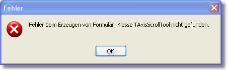

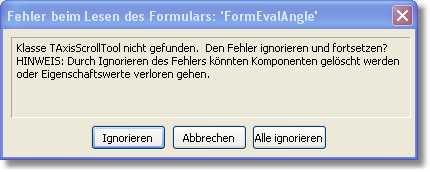

on my project, a form contains a TeeChart, which contains a ScrollTool.
When I open the form, I get an error message, that the scroll tool is not available.
I found two ways to make it available.
1. When I add a TeeChart on the main form, then add a ScroolTool, then delete that chart immediately, the problem is gone.
From then on, I can open any form and get all charts and tools.
2. When I get the errormessage and tell the IDE to ignore all problems, then close the form without storing, on the next reopen of the same form the problem is gone.
Using :
Delphi2010 Update 4
XP SP3
The TeeChart path is r:\AddOns\TeeChart Pro 2010\Sources\Compiled\Delphi14\Bin\
where r:\ is a mapped local path (using the subst command), that points to c:\compiler
That path contains the files dcltee914.bpl, dclteemaker114.bpl, dclteepro914.bpl, dclteeprostd914.bpl
The files in Windos\system32 mathes that bpls in date/time.
Any idea ?

Re: TeeTools on form not available
Hi Gerhard,
Is this only reproducible with an "old" project? If you can't reproduce this creating a new project, it will probably be that your project contains some invalid reference or is missing one that needs. To correct this, I'm afraid you should edit manually (with notepad or similar) your "old" project files (.dpr, .dproj,...) and correct the wrong references, if any.
If the problem persists, please don't hesitate to let us know.
- Newbie
- Posts: 8
- Joined: Mon May 10, 2010 12:00 am
Hello Yeray,
it seems you were right.
I deleted the .res file, Delphi created a new one automatically and now the problem is gone.
The original project was created with Delphi2006, then copied and opended with Delphi2010.
Thank you very much for the help.
Gerhard Sachs
Gerhard Sachs
