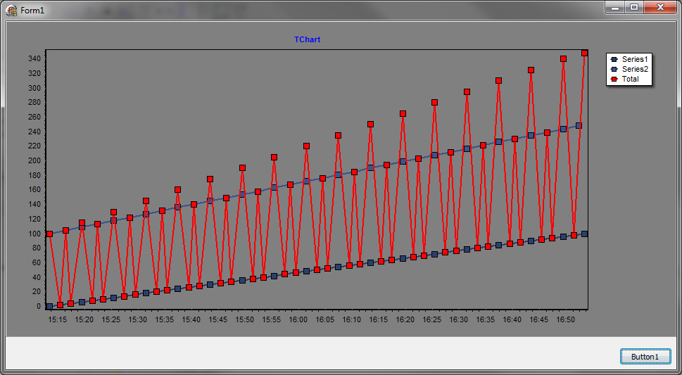

I got a new issue and i would like to know if i'm getting this issue because i dont use teechart the right way i should. I found a really big issue with the function when i use a datetime for the X axis using psRange. It doesn't seems to calculate it correctly because i have 2 different chart (teeChart and Excel) and when i do check it manually, TeeChart doesnt do it right. When using add function, If i have some series with less data than the others, the fun begins. It seems it doesn nearly the same thing as if it were set to psNumPoint because it doesnt seem to care about my datetime but only the number of points.
I did add a screenshot that show how it goes. The teal series is the total (add function) and you can see easely that the slope doesnt follow the time line of the other series. I hope there is a simple answer to that because otherwise, i will have to do an other add function that work well with a datetime base.

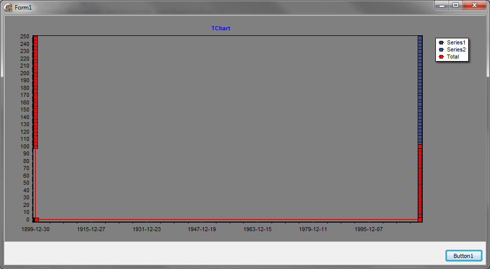

Ok, i found a way to show you the error and im pretty sure you gonna be very surprise with the result.
Here a Screenshot of the sample application As you can see, logically, add those lines would result in a straight Line with no stairs starting from 500. but what we are getting is how it add stuff in the wrong way.
I think we will have this issue with all the function so far, because it seems to be a DateTime baseline issue.

Sorry, i havent seen you had reply on this one. I did try the "workAround" but no, it doesnt work at all. i got lots of points that goes to 1899-12-30 (wierd because the AddNullXY(TheDate,0)
with the copy of the workaround
- addfncbug2.jpg (92.31 KiB) Viewed 13882 times

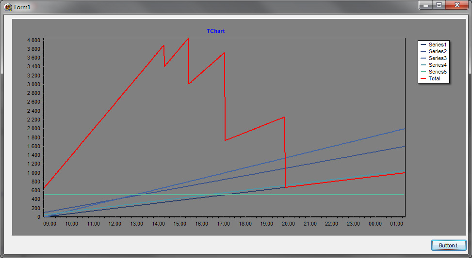

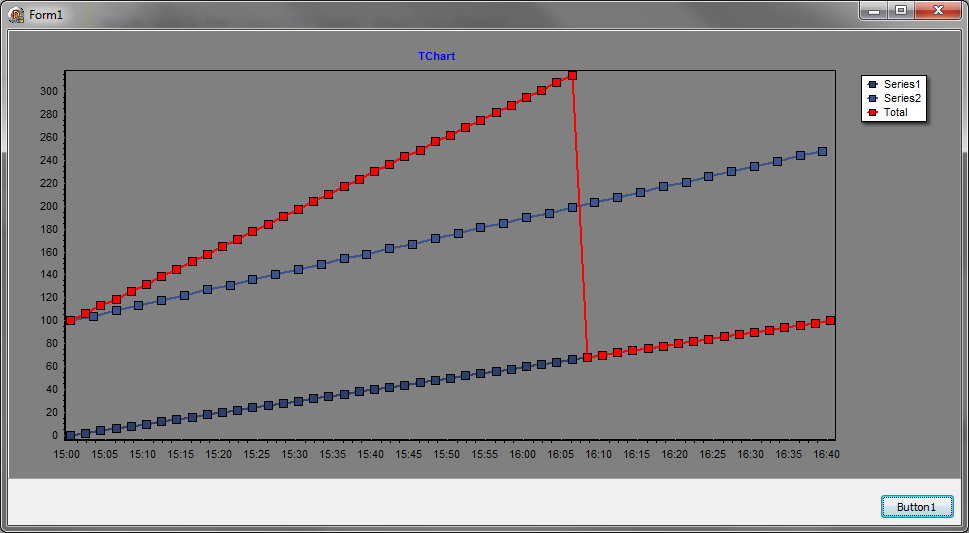

Ok, i did managed to solve the null date by doing
This is what i got
As you can see, It is very a theorical workaround and not a practical one. I did others test and the best i could get so far is this
To get that line i had to change the workaround by changing the Y= value 0 in the addNullXY to the nearest old value of the adding series
If you come across a beter idea, please let me know.

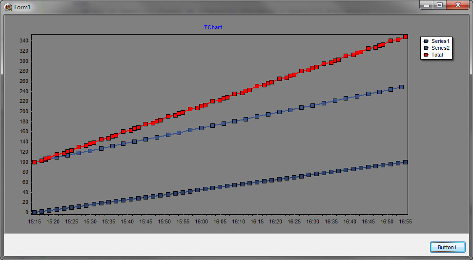

Re: Function with time issue
Hi GoToXY,
That's right, if you want your function to consider the "missing points" to have the value on the line, another option could be calculating the interpolation point instead of using the last YValue.
Take a look at the demo at All features\Welcome!\Chart Styles\Standard\Line (Strip)\Interpolating Line series
Yes, i did it 1 hour ago, just havent got the time to paste my code here tho. Oh i didnt know you guys already had done those thing in the demo. Anyway, everything is working fine now.
Thanks again for your support!
