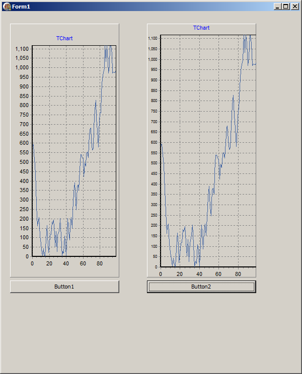

Could you please try with the latest version available at the client area (v8.07)?
Here it is the result I'm getting compiling your project and clicking the button 2:

Hi johnnix,
If you can't upgrade to 8.07, can't you apply the changes Narcís explained here to the v8.06, so that you can get both issues working fine?
I've just checked it and the v8.06 with the mentioned fix seems to solve both issues.
