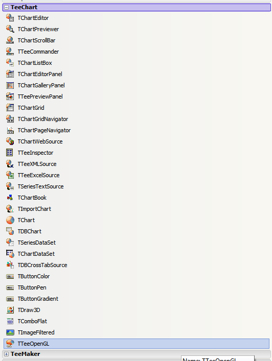

but when I try to load the Delphi2007 project into Delphi2010 I get an error message that the TTeeGDIPlus component is missing.
And that is true you can see that by looking at the attached screen shot of the Tool Palette.
What can I do to get the TTeeGDIPlus component into Delphi2010?

Yes, this is a known issue (TV52014792). The problem is that GDI+ canvas uses third-party libraries that crash with C++ Builder. Therefore this component can not be installed in IDEs with C++ Builder personality. We are working on solving this for future releases. In the meantime you'll have to use GDI+ canvas at runtime as shown at the All Features\Welcome!\3D Canvas\GDI+ Canvas example in the new features demo, available at TeeChart's program group.Then I used the binary installer to install TeeChart2010 into Delphi2010, this seemed to be successful,
